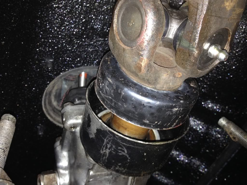

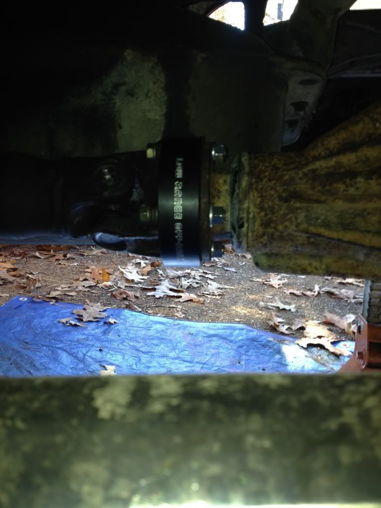

    One more thing. My drive shaft was too short. It was like that when I bought it but I ran it anyway since I had zero luck finding one in the junkyard that wasn't bent. The damn fork trucks would bent them when they lifted the truck. When I swapped the motor in, I had to mount it about an inch forward to make the heads clear the firewall. This pulled the trans forward and made my driveshaft issue worse. I did not want to spend big cash on a custom drive shaft only to have to spend again when I put in the ford 8.8. I found a cheap solution at Low Offroad.

    Simple but effective. My shaft is too long. Lowering the back so much shoved it into my trans. Not sure if that's why my first trans blew up or not lol.
