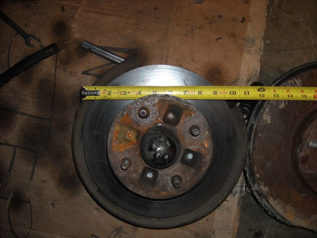

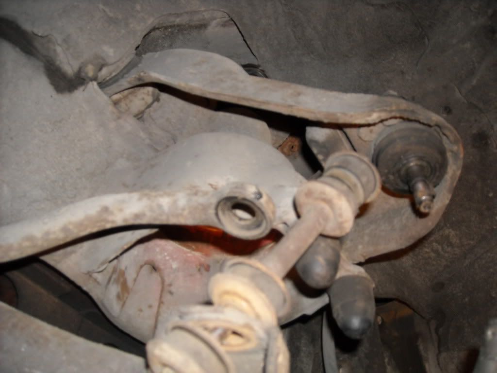

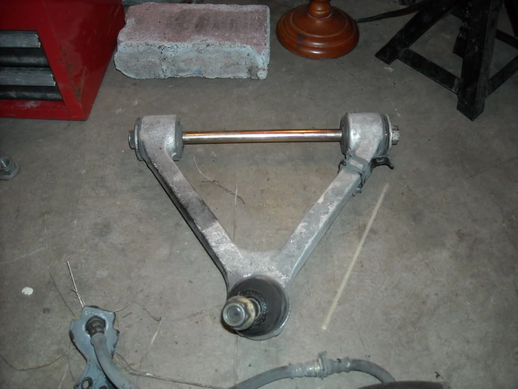

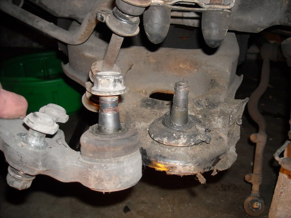

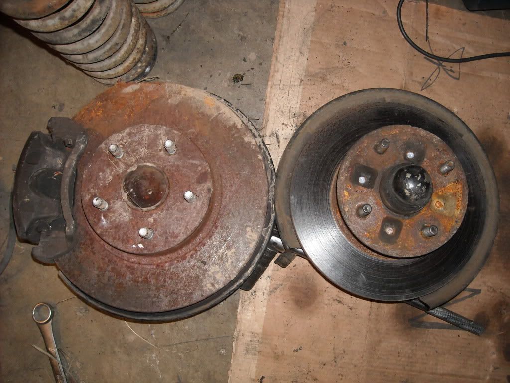

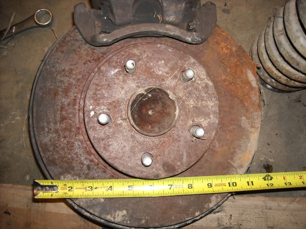

    did i mention the spindles from a 87 supra with 11.5in vented rotors and 5lug
    turns out the ball joint diameters are not as close as id hoped

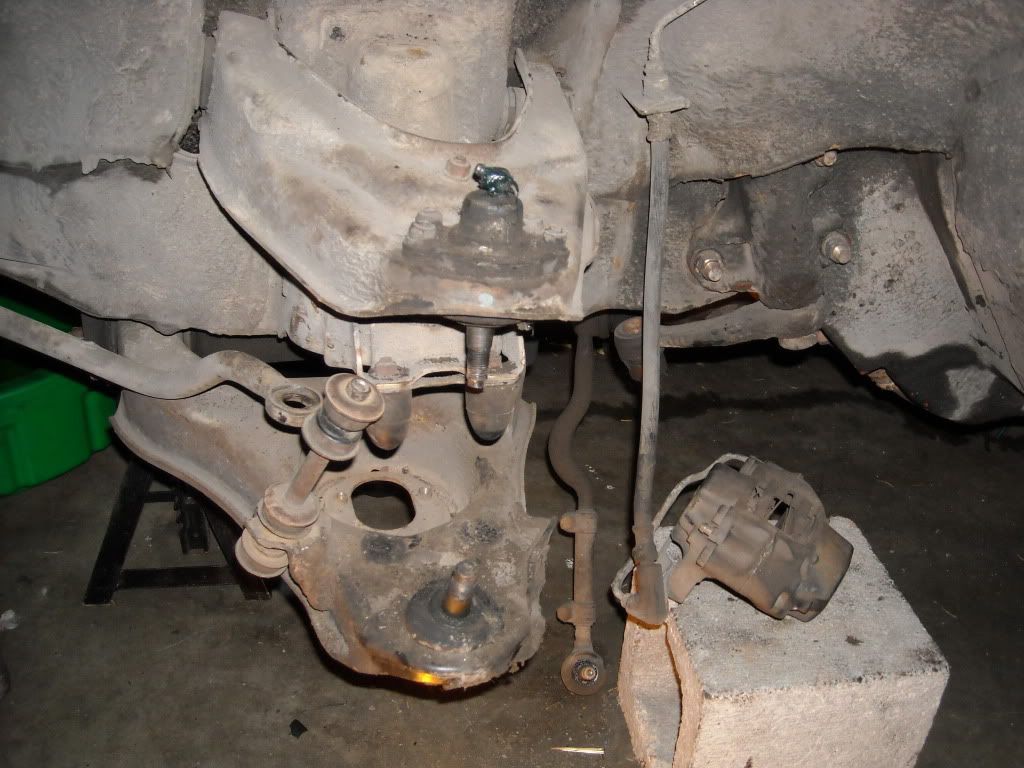

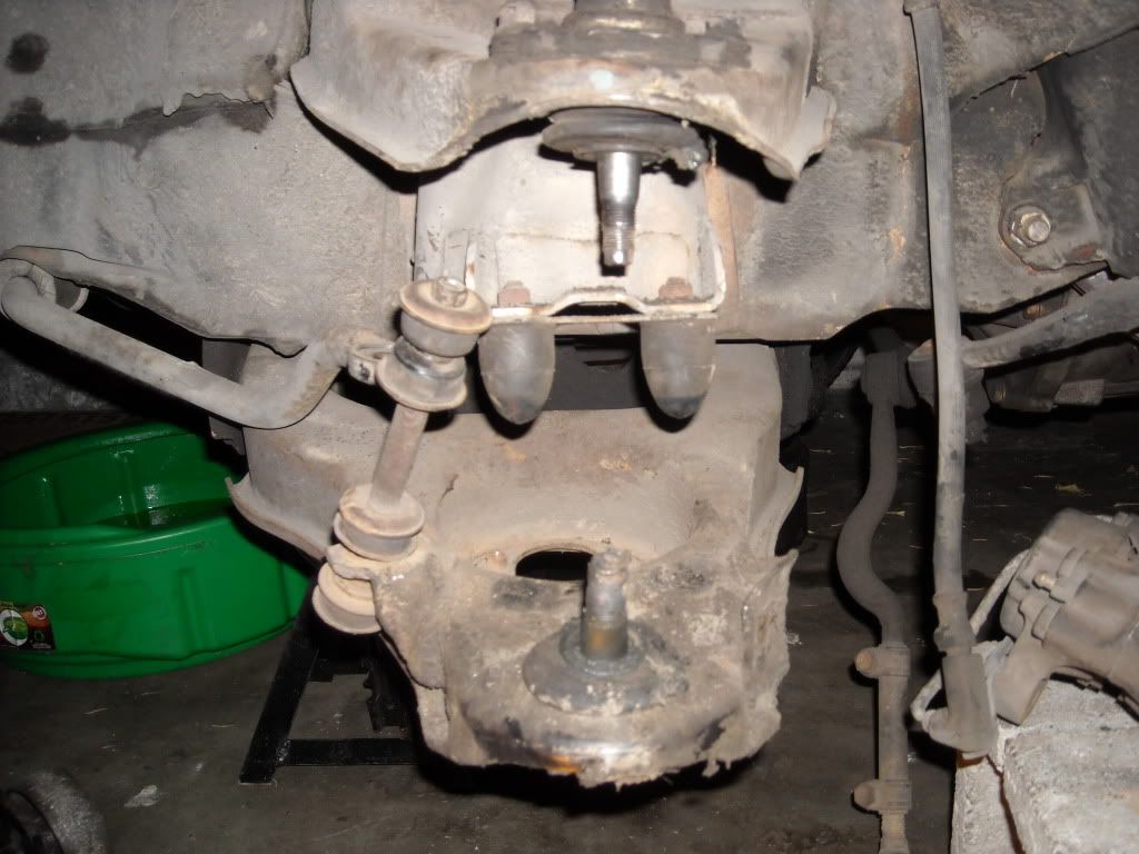

    so im gonna hit up the parts store and see how much bigger a later truck balljoint is. i believe they mount the same, we'll find out. or ill attempt to use the stock ball joints, the lower (above left) looks pretty easy to mod to fit, but the upper is pressed and the arm is way wider then the corona arm
    heres some gratuitous comparison pics
    9.5in for those counting at home.
    and a couple random pics of my stock suspension
    and a shot of a hilux spindle for comparison

    turns out im completely wrong about the swap, wont bolt up, but is possible with a lil fab im not willing to do atm.

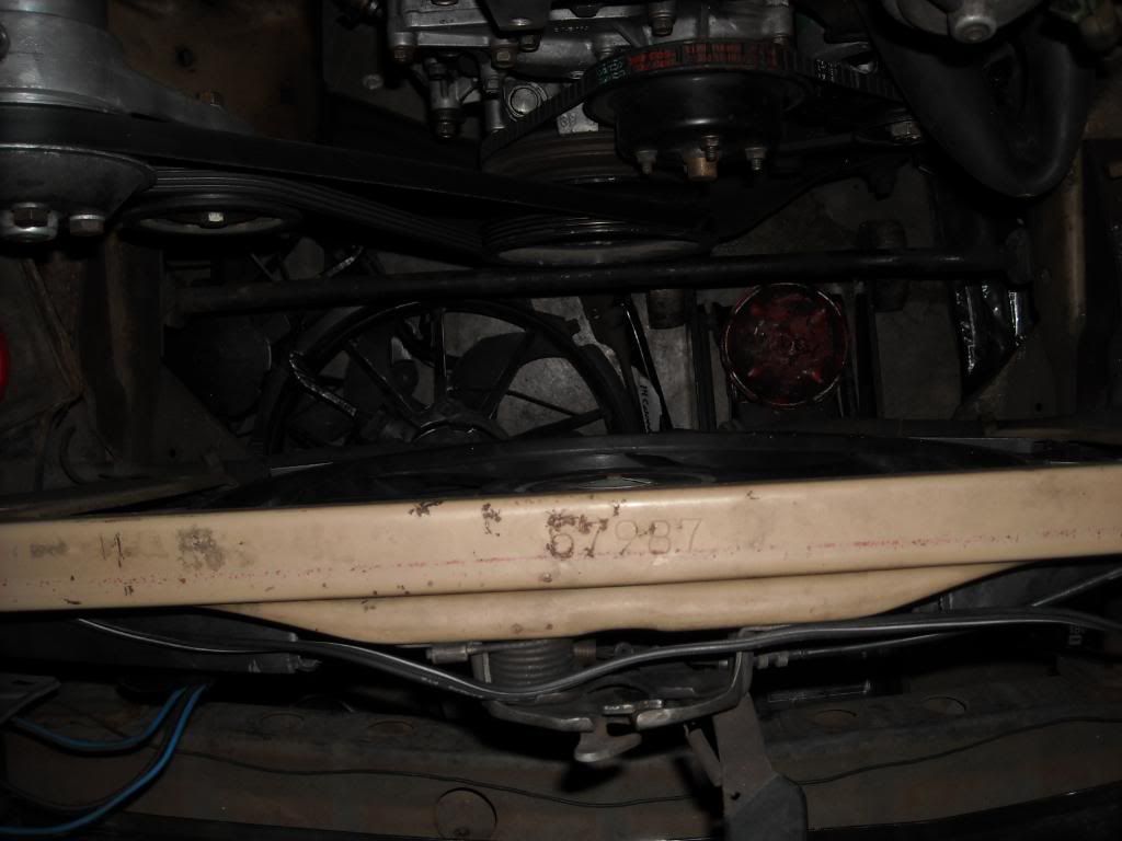

    your radiator fan secret should be zipties. comon 'Nuff :D

    cin- was zipties, upgrading to bolts.

    there is nothing the same as a truck, ball joints have a much smaller shaft and taper, the upper does have the same bolt pattern tho, lower isnt even close and would require welding up the stock holes then plating it and re drilling.
    both arms are 100% different, tho it looks like it might be possible to put truck arms on the wagon, only about .5 in difference where the pivot bushing is, but on the wagon it has a bushing like a leaf spring pressed into the arm, more like the supra upper.
