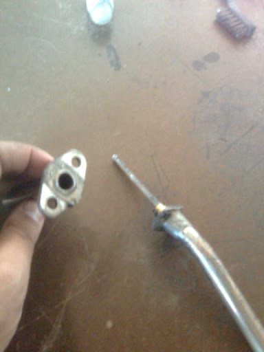

    I did some slight transmission work. Now i orignially wanted to swap a 5 speed trans but decided to stick with the really rare A30 automatic trans, it shifts really nice, and it is really unique. It is the appropriate fit for a cruiser. the first order of business was to fix the trans dipstick. I have no idea how this happens but the previous owner managed to break it.
    if you look close you can see some JB weld that some one had used to try and fix it. I pulled it out, cleaned it up and welded it up. I applied a thing coat of epoxy to seal any possible holes in my welds. unfortunaly i for got to take a pic before i put it back in.

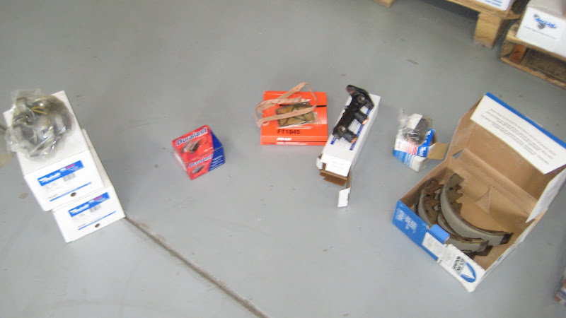

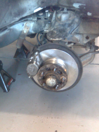

    Next i did some brake stuff. Before i had mentioned that when i had taken a 45 min drive in the truck, my brakes got spongy and i lost most of my fluid out of the rubber cap of my master cylnder. Safty is a huge deal to me, and I don't mind paying an extra bit to make my rides safe. so I replaced the master cylnder, front calipers pads and rotors and rubber brake lines, and repacked the bearings. Everything went smoothly untill one of the fitings that threaded into the master :brickknock: so i had to rebend a new steel line.
    Finally I replaced the trans pan and filters. Estimated time to complete :2 hours. Actual time, 6 days:verdict_in:
    I dropped the trans cross member and unbolted the pan, cleaned it up. I pulled out the trans gasket that i got from rock auto, only to find out it was the wrong one. Crap, I called the parts stores in town to see when they would have the parts, they all said it would take them 2 days. So i waited, and when i went to pick it up, i found it was the wrong :brickknock:one:brickknock:
    finally i went behind the counter with the parts guy to look through the book he had and pointed out the one i needed. Aparently the A40 trans is more popular in the 70's toyotas. So finally i got it another 2 days later. bolted it up and away i went.

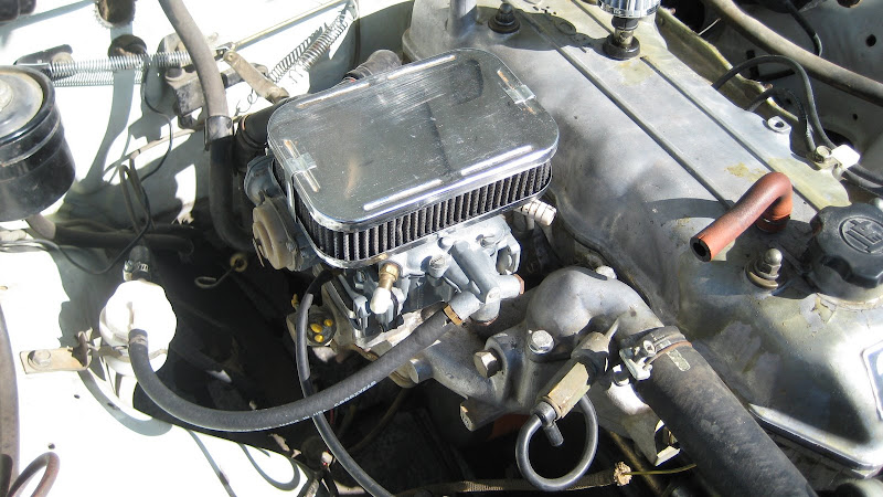

    I had a difficult time with the trunk idling with the butterflys of the weber open. Everyone said that it sounded like a vacuum leak. I looked everywhere, until I mentioned it to my auto parts guy, who said that the 20r and 22r have a common problem of leaking between the head and the intake manifold. He suggested that I shoot that spot with carb cleaner and see what it does. it started to bubble up like crazy. So I used rtv and doubled up the gaskets to make sure it doesn't happen for a good long time.
    It ran alot better, but still had issues, so I went through the carb again and this time did a carb dip. Then it started working! woohoo!! now she idles nice and smooth with butterflies open, with the help of an extra spring for the throttle return. Most people don;t need this spring, but i have an auto kick-down so i needed it.

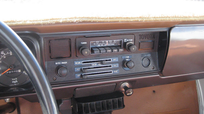

    This is the radio I put in, It is not a truck radio but it is at least period correct, it is out of a celica. It is just for show, its not even wired up, but it makes it look more complete.

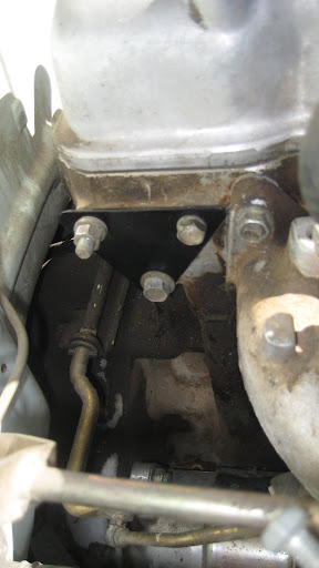

    I am working on eliminating some of the emission things to clean up the engine bay, since my truck is exempt from emission testing. this is my custom ERG bypass plate.

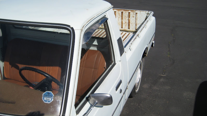

    Last but not least window visors, I picked them up the other day at the junk yard, I think they look pretty sweet and i got them for 5 bucks
    Also pickup up a set of white hub caps in really good shape for 4 bucks, i don't like them nearly as much as the chrome ones. but they are great for the winter!
    Lemme know what you guys think:funnyup:

    I love this mirror, mine is the only pickup i have seen with a single stock mirror, I do not really understand the love affair people had in the 70's and 80's with giant square mirrors. I know it was an option and they were called Western mirrors, big ugly mirrors, I don't understand..

    The ones that EVERY truck had on them, was a dealership thing. Most got them. That's why they covered the stock holes with them.

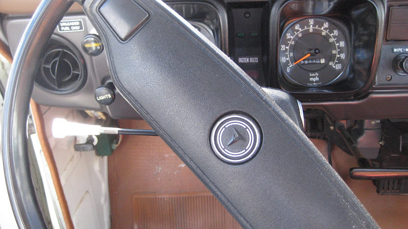

  20. toy_boy
    toy_boy Addict
    Nov 8, 2008
    601
    California
    1979 Toyota 4x4
    Awesome job with your truck! Really love the effort and detail you put into the interior.
    My 72' came with it's single stock mirror, too. Love it so much I found a few torx screws to replace the regular stock ones holding them down (did my crack-free vents as well) - just to slow down any thieves. :D
    I feel kinda lucky that it's there because almost every other HiLux I've come across (in person) didn't have it.
