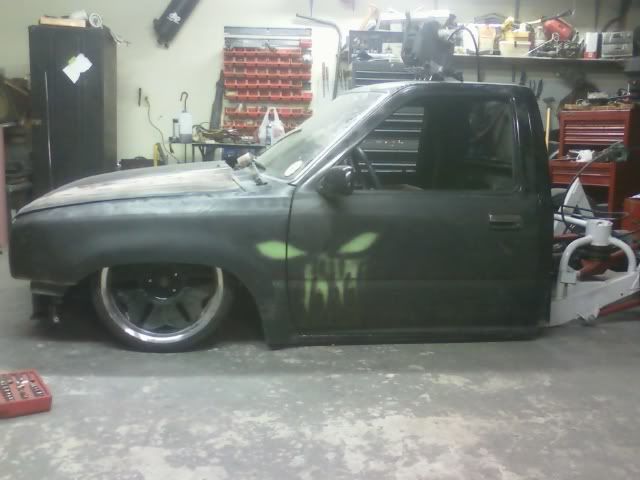

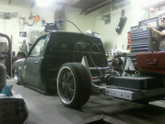

    Havnt been on here much guys, Just been workin on the frame "z" and bodydrop everyday after work. Everything is bout done just puttin everything back together now.
    "Z"
    Cut
    Marking out lines for the bodydrop...

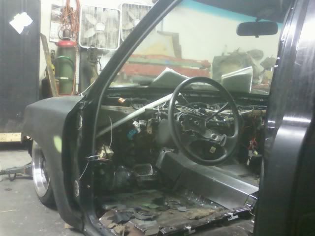

    New tranny tunnel
    Full Lift
    Did not want the engine sticking out the hood so this is what I came up with
    Had to cut pedel and make a box around the shifter linkage because it was hitting the floor...
    Body getting back together
    In a little bit ill upload pics of the bed being bodydroped and the truck laid out in the driveway :D

    Full lift in front...
    Layin body :D

    Thanks dude. Yeah mostly. My buddy finished the hood cause i didnt go up for a couple days. and he cut my filler plates and wheel tubs for me while I wasnt there. He cut my pinch weld off also. ****s almost done. I gota get some pics of the front. The other day I made new bumper mounts and mounted the bumper and valence, And sectioned 3 inches out of my shifter linkage and welded it back together. Just got to seam seal the bed yet and prime it and Put the interior back in

    I started redoing the suspension in may and the frame z and body drop i started maybe a month ago if that...Its taken me a while because I work 10 -11 hours a day and then I go out to my buddies house to work on it for bout 4 hours. And I dont work on it everyday. Cant wait till its done. Im trying to get it done for grounded 4 life show next sunday.
