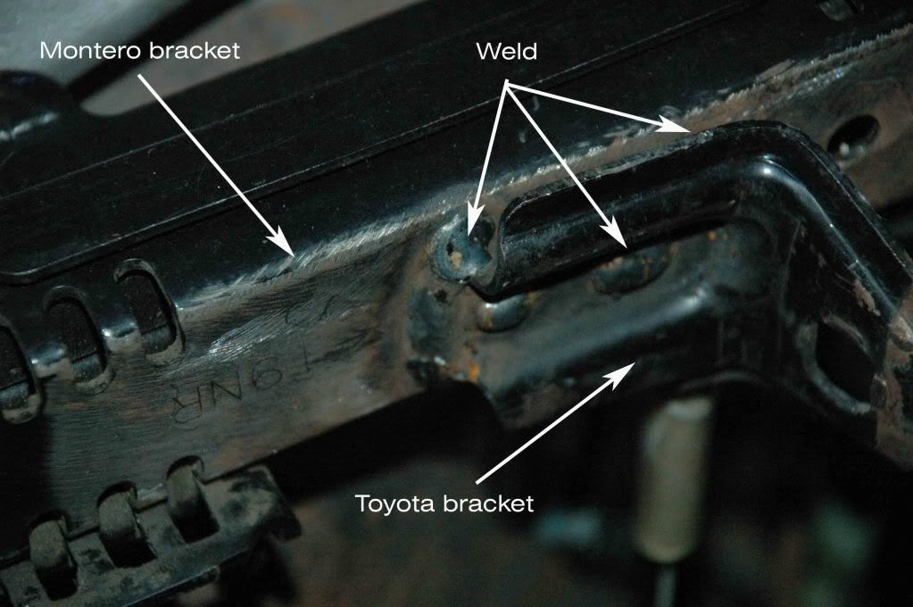

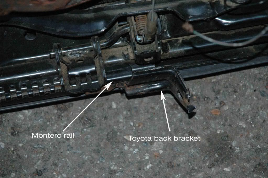

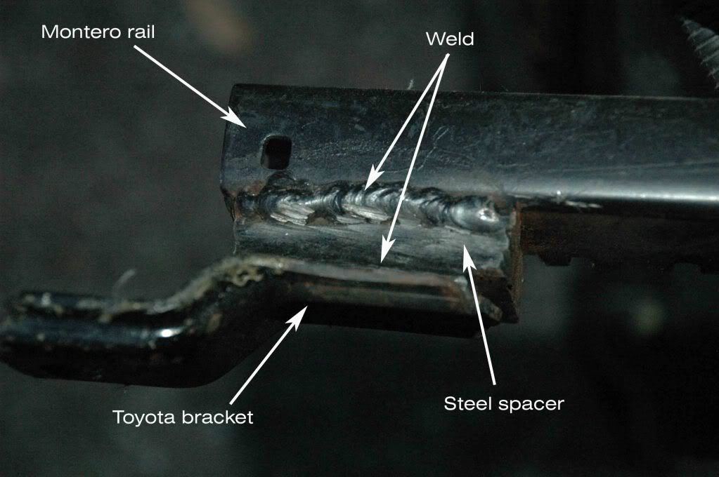

    What I did first was to cut off the montero brackets and threw them away.. I then went to the junk yard and hacked off the brackets and rails from two toyota bench seats ( two because the each bend has two brackets - a pair for each seat) then I welded them to the montero seats (part of the rail that was left from the old montero brackets). I'll take some pictures tomorrow though..

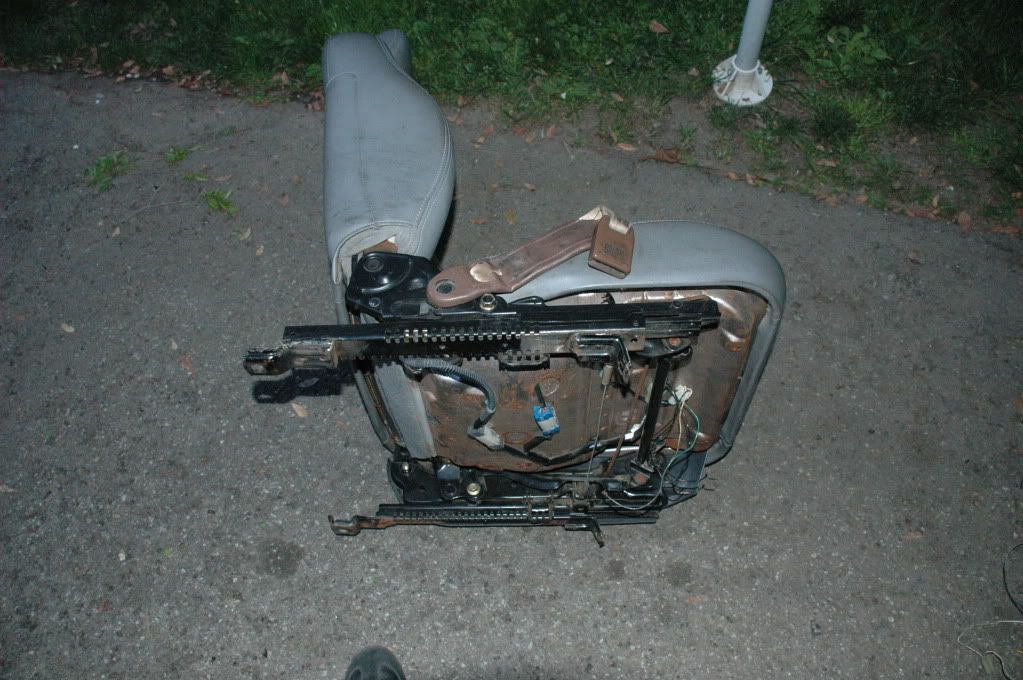

    Here are some pics of the montero seats
    Montero seat (still need to get the right seat belts):
