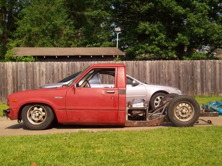

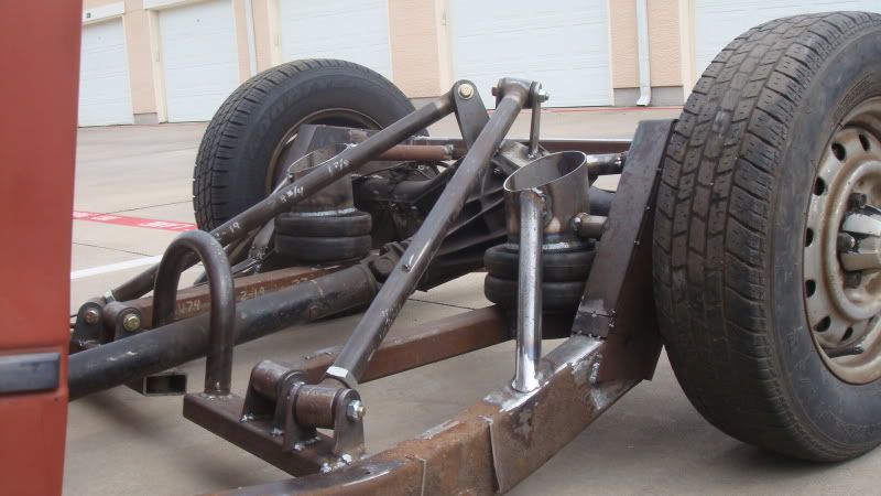

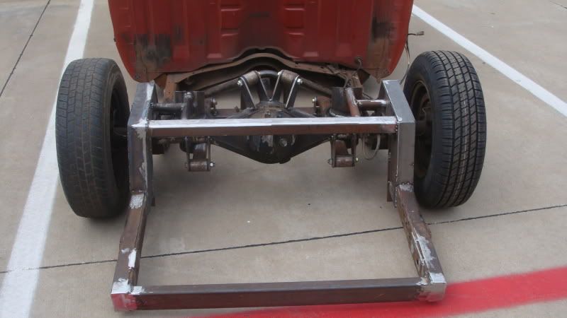

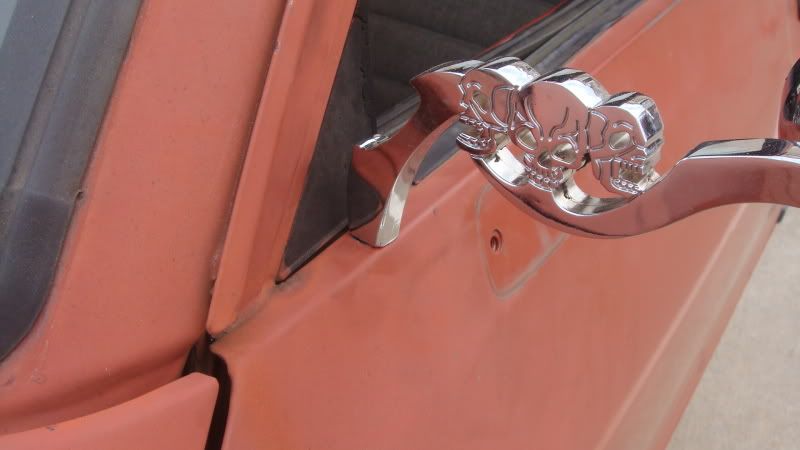

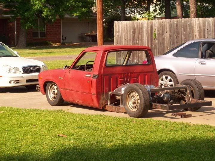

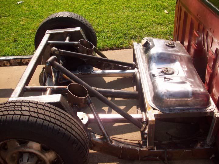

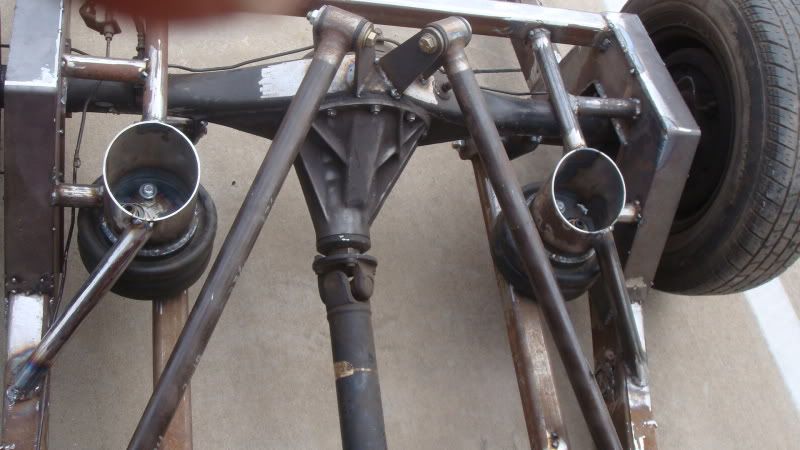

    got some more work done, not as much as i wanted cause i ran out of wire, again, i had to to buy a small roll so it didnt last long but anyways, everything just needs to be finished welded up now, i still gotta build the gas tank mounts and air tanks mounts, but other than that, the rear is pretty much done, also got the mirrors mounted but...here a few pics to enjoy

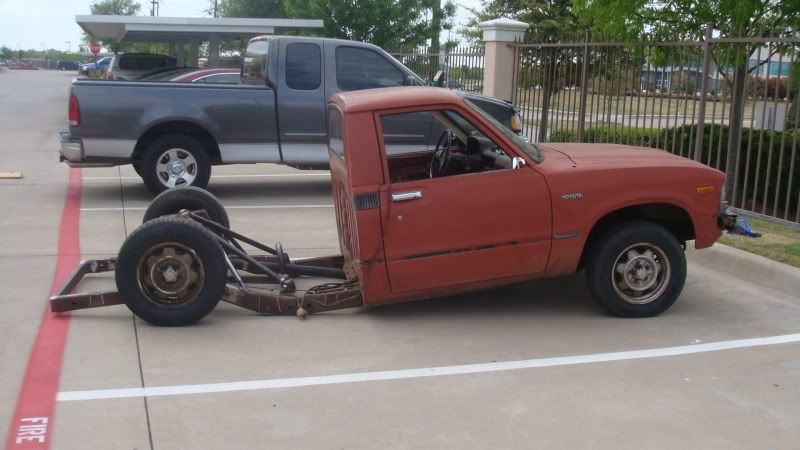

    got the front end torn apart and iits about as low as it will go right now. the other 3inches its need to go is beyond my capabilities, also got the gas tank mount built, all the holes in the frame have been welded, the back is pretty much done except for mounting my air tanks and compressors, as soon as i can buy my own chop saw and sawzall, i can start building the brackets for the front

    Is the front bagged now? I like the tuckin you got going but im curious if thats just a static drop? If it is than Im stoked because Ill keep my 14s on if i can ride like that on the road.

    the front is ready to be bagged, eveything has been taken out though, shocks, torsion bars, sway bars, bump stops, so no u wouldnt be able to ride around that low all the time because you wouldnt have any suspension in the front what so ever

    truck looks like its coming along nicely. you may want to set a bumpstop in the rear so the axle doesnt go in too far and take all the weight off if you plan to drag it. especially if you do it with the front up and back down.

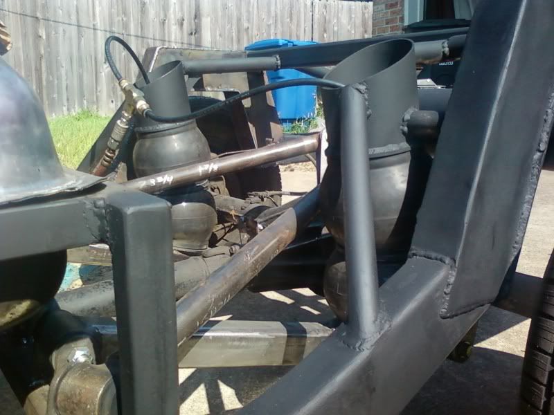

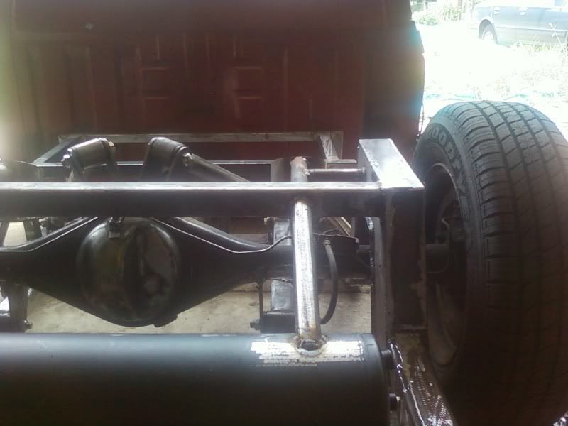

    got the air tank mounted today, i really like the way it came out, the only thing left in the back to do fabrication wise is build mounts for the compressors and the battery, which i need to find some steel plate, everything else just needs to be grinded down, which sucks

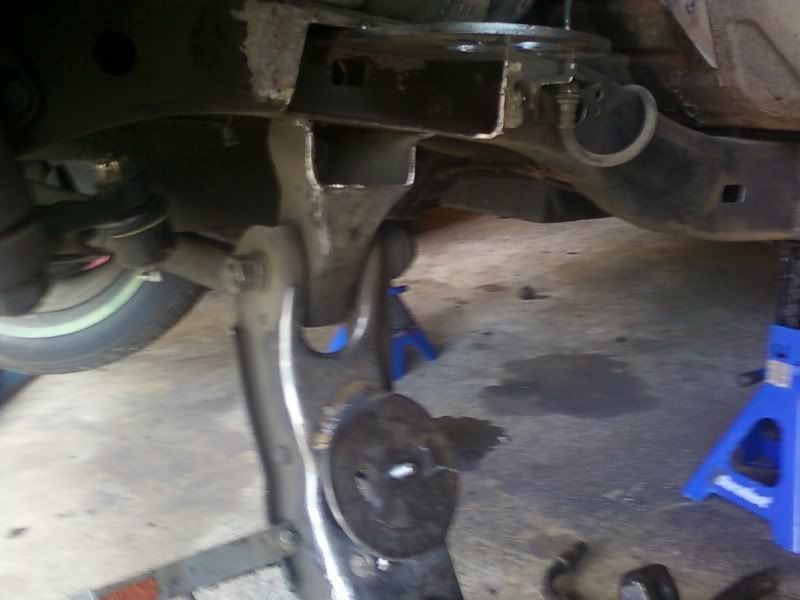

    alrighty, got the drivers side front almost done, i still gotta go back and cap everything so the strength will return, but other than that, just have the passenger side left and the front will be done, i get back up to stock height which is great so anyways, on to th pics...
    i had to cut alot of **** to get that slam re-7 in there
    yes i gusseted the upper bag mount, you just cant see it, i 4got to snap a pic while i had everything apart
    no the bag doesnt rub my link bar, its close but i got it as close as i could
    stock height again, i was actually suprised

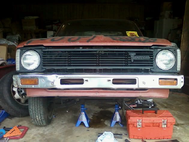

    well, i got my front end today, as well as a few engine parts, gonna be shipping my control arms off to bio kustumz to have some tubular upper made..anyways heres a few pics to enjoy...
    the old 83 front end
    the new but even older 81 front end, dont worry about that gap, the hood wasnt closed all the way

    make sure you buy stock in bushings as you will be replacing the ones in the lower bars a lot..
    and i sure hope that four link rides ok with zero instant center and prob no anti squat built into it.
    but im sure you know that its not your first rodeo... but hey if it lays out who cares right:rolleyes:
  20. bagged83yota
    bagged83yota Member
    Mar 12, 2010
    53
    bossier city, louisiana
    1983 toyota reg cab longbed
    what is an anti squat bar??, never heard of it, as far as my 4link goes, itll ride just fine once i add some shocks. but thats fine, u wanna make me look like a dumbass then thats fine bro
