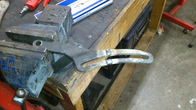

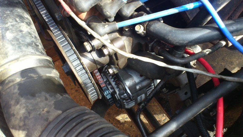

    here is a supra alt on my old bush truck just swapped over with pully change and had to extend the alt slider and space it out with washer or 2 and the alt is fair amount bigger then a 22re one
