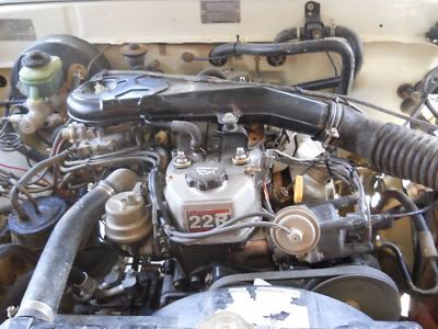

    i got a lot done today. and i ran in to a few snags so here we go:runaway:[​IMG]motor back in[​IMG][​IMG][​IMG][​IMG]:thinking:

    i use my stock loom and flip it. im going try a flip the motor loom to but i might run in to more problems. the big one now is the clutch master dose not fit, it hit the intake. i look a round aus. and the UK and it seen that they didnt make a 22re in a RHD. heres mine[​IMG][​IMG] it fits without the EGR [​IMG]

    Ditch the EGR, I did on my 22re. Still ran fine. I ended up stretching the harness to get the steering on right and a/c on left. I should have flipped the entire harness and repinned the blinkers.

    Oh, I took the idler and just mounted it on the left side. Two of the holes lined up, 1 didn't since it was backwards. Then I drilled it and put the bolt in. I also cut the 3rd ear off the frame for the box and moved it to the right side.
    Get a clutch master from an 85 and delete the EGR and you're probably good to go.
