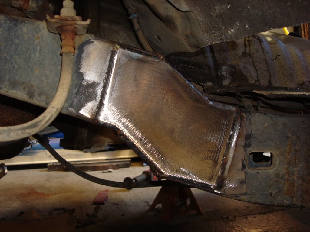

    I finally got to do some actual welding on my truck!
    I just need to weld the other side up. It is all tacked in place. Then I think I am ready to drop the body. I left a few inches of floor at the front and back corners of the cab to hold it until I was actually ready to drop it. I was wondering about moving the cab back a 1/4" or so. Is there enough slop in the body mounts? After raising the engine up 1.5" it's pretty close to the firewall, and I still need to drop the body 2.25" so if I could squeeze a quarter inch of clearance by moving the cab back a little it would be nice.

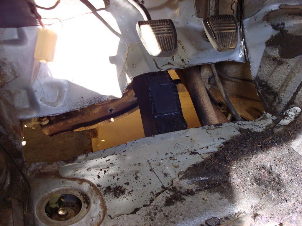

    I plated the frame on both sides and realized I had to open up the firewall openings on the floor to clear the exhaust and clutch linkage. Anyway I cut those bigger.

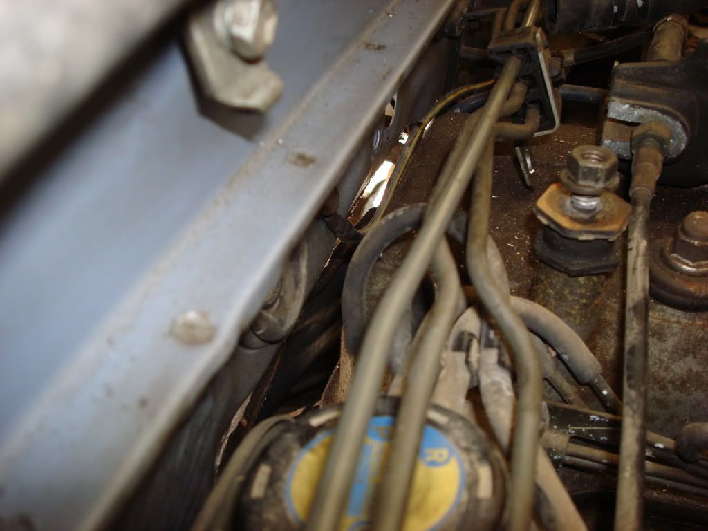

    Now about the only thing stopping me from dropping the body is this little pinchweld seam.
    I wonder how people usually deal with it? I am guessing flatten it down agaisnt the firewall? I pulled those brake lines out of the way. They were right behind the engine. I will have to move them up once I flatten out that seam. Also I am still wondering about moving the cab back slightly or if that wont work maybe I should reshape my firewall a little bit. Try to pull it into the cab an inch or so? Any advice?
  6. burnzya

    fish plates look great! good job man!

    i think you could get away with a 1/4".

    Thanks!:D I like this part of the job a lot better than the cutting of the cab. I'll be moving on to the front of the frame soon. So what about that pinchweld behind the valve cover? Should I flatten it out against the firewall?

    Welds look great! No grinding there!:cool:

    Thank you for noticing! I'm glad you are checking out my body drop project. I have checked out your ride in MT magazine and on their website and it is an amazing truck! It is inspiring for sure. A very quality build in every aspect!:waytogo:

    won't the pinch weld clear once you drop the motor mounts?

    :doah:Ahhh right. Forgot about that. It will just clear as it is, but it will be basically right on top of the valve cover but I will just do it that way for now. Thanks.

    Very nice work on the z...looks very clean and stock..good work. I would just hammer the pinch flat like you were saying to get clearance.

    Thanks still2hi! I might do that with the pinch weld but the motor mount thing might take care of the problem.
