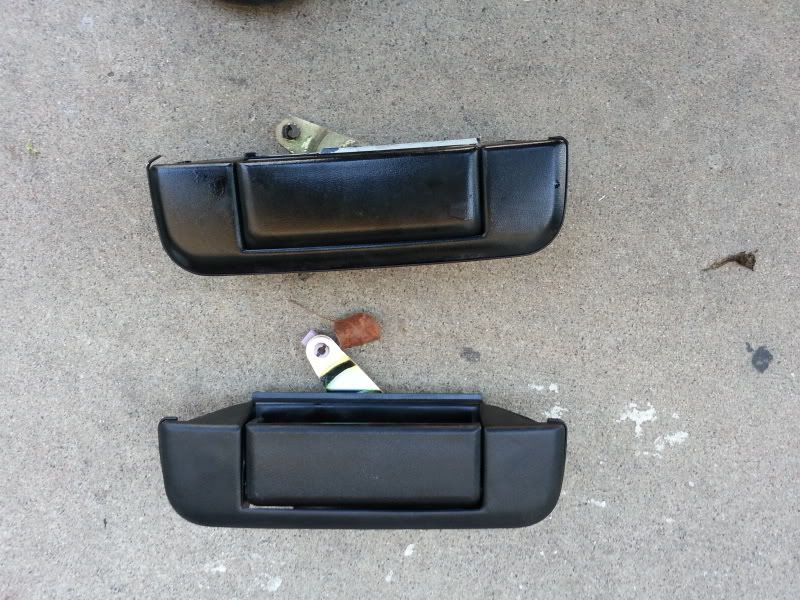

    Last week my tailgate handle broke. Ordered an aftermarket replacement from Amazon. It was cheap and had good reviews. It's OEM spec. looks great and works...easy install.
    I cleaned everything using WD and regrease all the areas that need be greased. opens and closes nice and smooth now.

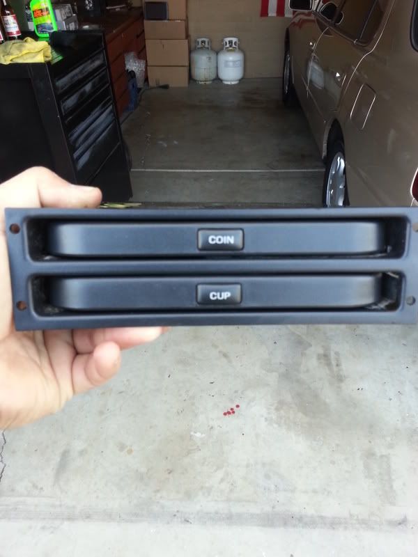

    Also from the junkyard I picked up this cup holder/coin holder from a 90's Ford Taurus. I'm going to be using it on my 95 4Runner but just fyi for anyone lookin to do this on a mini. It replaces the single den empty bay under the stereo.

  20. scrub88
    scrub88 Toyotaholic
    Apr 14, 2007
    1,685
    10
    tn memphis
    88 toy short bed
    That's genius idea I'm always sticking my drink In between my door and seat . Great idea/mod
