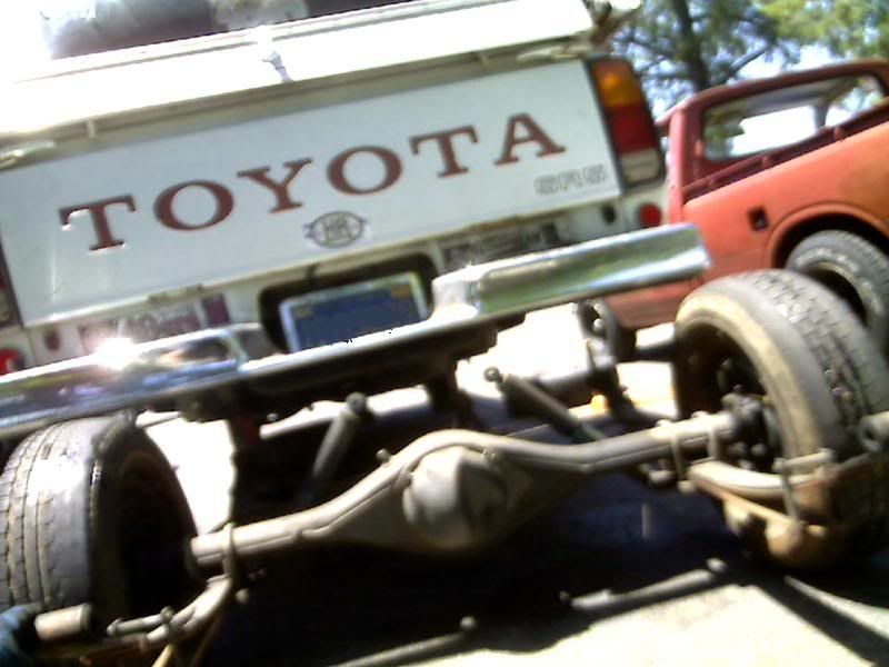

    Finally got the rear differential, leaf springs, shocks, and drive shaft out of the 77' swapped over to the 72'.
    Next, the 5speed and entire front clip. :D

    Even between my '72 and '77, not everything was exactly a "bolt on" swap. For example, the mounting holes of the front cross members do not match up. But the components themselves; upper and lower arms, idler arm, pitman arm, etc. are all the same and swappable.
    The center links between the 2 trucks was ever so slightly different as well. Particularly where the inner tie rod ends bolt up to it. Swappable none the less. But it made an alignment not just a good idea, but an absolute must.
    One other thing I learned while taking bits off the newer truck was that although the flywheel and clutch off of a 20R will bolt onto an 18RC with no issues, the 20R flywheel/crankshaft bolts are different than those on the older 18RC motor.

    No difference. Other than the fact that the rear end on the '77 had new seals, wasn't leaking, wasn't all rusty, nor was it caked with decades worth of grime like the one originally on the '72.
