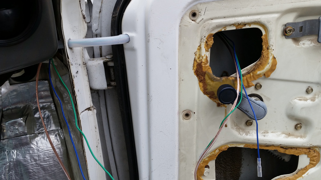

    It has been raining here in so cal for the past few months and it has put a damper on my resto/customization project. I have been trying to install automatic door locks in the truck for the past 2 months and between the rain and me chasing tools this has been the longest installation part of this truck, the suspension did not take this long. So after a few hick ups and tool collecting I was able to drill the necessary wholes and install the solenoids.
    Passenger and driver side doors this is where they sit in the door, this is driver side. After this I drilled the doors and enlarged the cabin side walls where the door light switch was installed. I had to enlarge it to be able to install a piece of plastic tube to run the wires throw. I'm also thinking of adding automatic windows as well and also speaker wires for the door speakers. I needed something thick enough to hold 7-9 wires. So I went with a .5" plastic tube from Orchards its like $.39 a foot.
    This slides in out of the cabin as the door closes and opens, at the moment the plastic tube is giving the door a bit of hard time closing as it slides in and out of the door. With time this will get better, and i have a bit of room to add the wires in for the windows as well. I also had to do some bending and adjusting of the parts that came with the locking mechanism to fit my truck.
    Lets hope this little piece will hold over time. I have 2 more but I will hate to take the door panel off once in a while to change this piece. Will see how it goes so far so good.

    I have had time to work on the truck these past few weekends. As I knew it the plastic tubes in the door wore out a lot faster than I taught. I changed them do these door looms. They work and look a lot better. [​IMG]

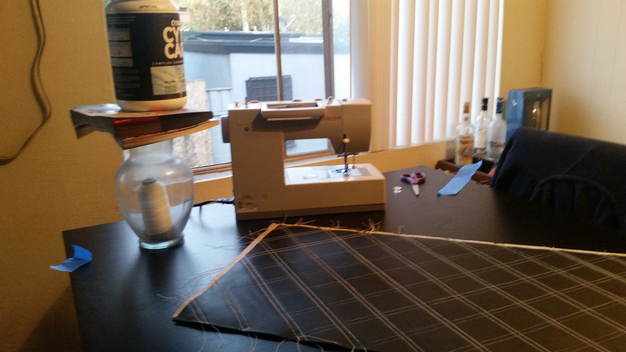

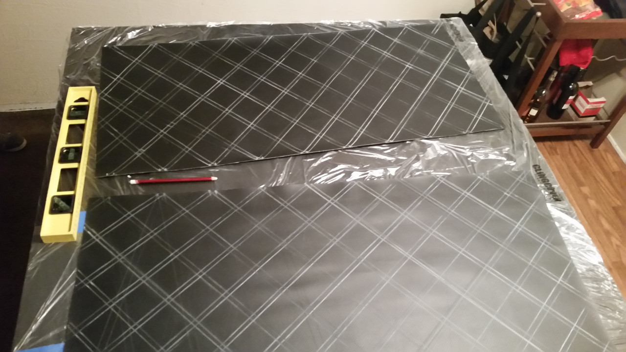

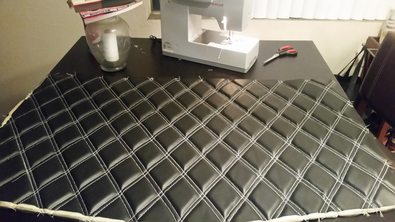

    Its been a while since I been on here and posted anything about this truck. I have been working on it but with life being busy I only had time to work on sat for a few hours. I have been focusing on the interior. I bought material for the door panels and the head liner, perforated vinyl and foam, glued them together and sowed them up in a diamond double stitch pattern.
    Here I have mocked them up so I can sow.
    This is what it looks like sowed up.
    This is the headliner. I used thicker foam to get that fabric to bubble out.

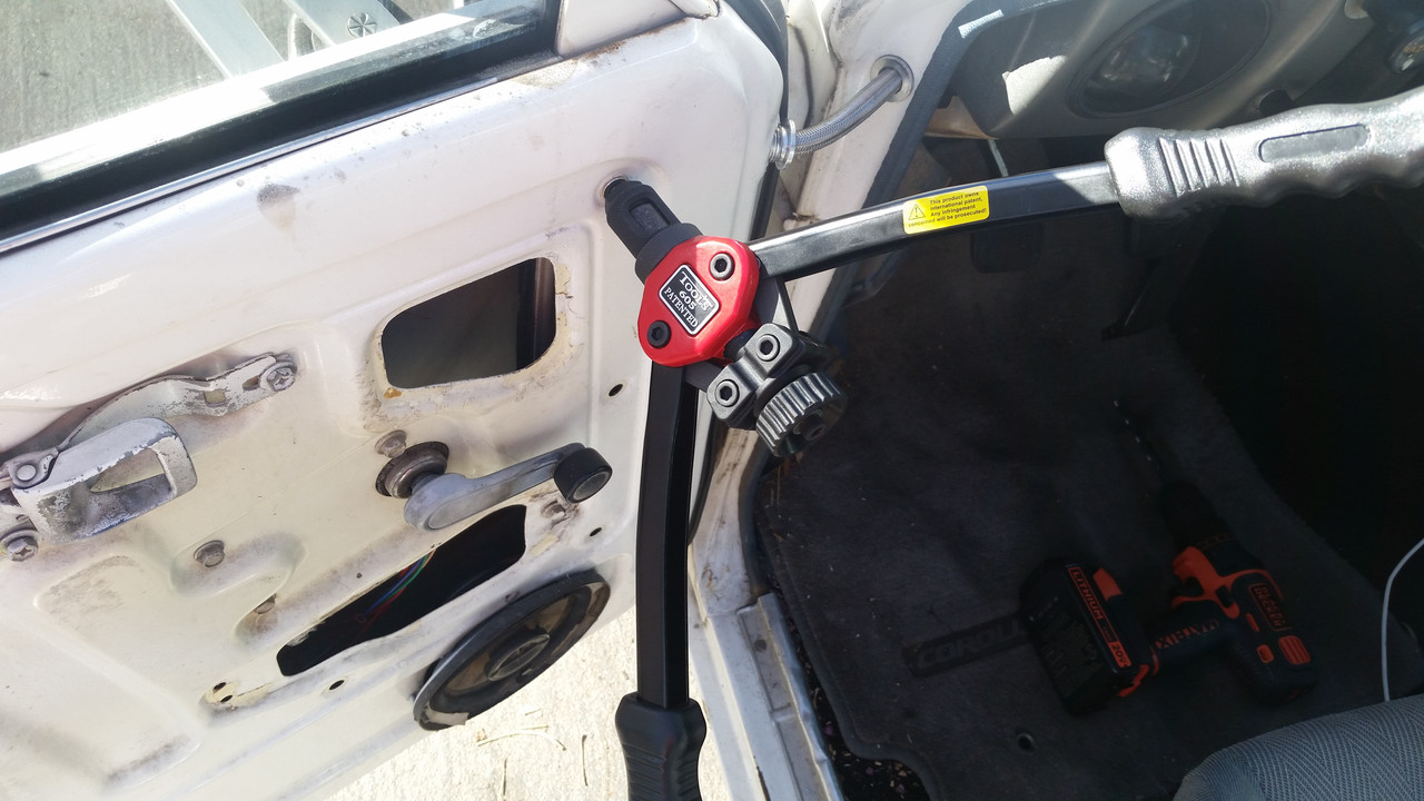

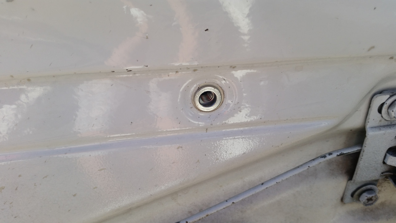

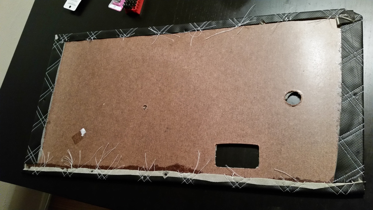

    The door panel cut and glued I will attach them to the door using screw rivets instead of the OEM plastic clips.
    This is what the rivet looks like I just inserted them in the same wholes that the OEM plastic clips were. I needed to do a little bit of finessing with a drill. Then used the rivet tool to secure them in the door.
    As of right now I can not install the door panels just yet because I don't have a handle to close the door with. Right now I'm using the wholes in the door to close it. I plan on building a strap out of seat belt material to close the door with. I will post pics of that as well. But first must change the differential gasket, cause its leaking.
