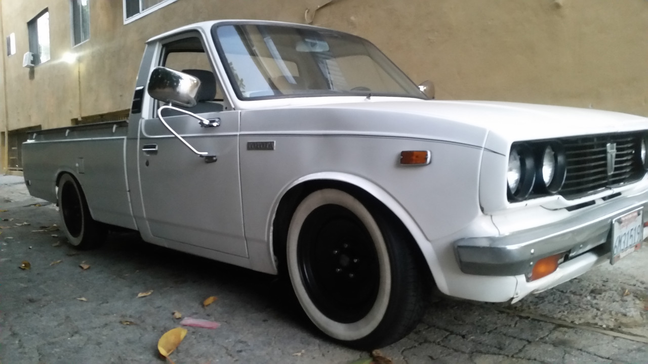

    So had some time this weekend to work on the truck a bit finally lowered it again in the back. I have found a height that I liked. I guess measuring it and fallowing the measurements don't work for me have to literally lower it 3 times to get the height that I like.[​IMG][/url]image hosting 10mb limit[/IMG] Now the back matches the front. [​IMG]
    I have a question for you guys that are this low with their trucks. At slow speeds and big bumps the axle bangs on the frame is that going to mess anything up besides make noise and be bouncier?

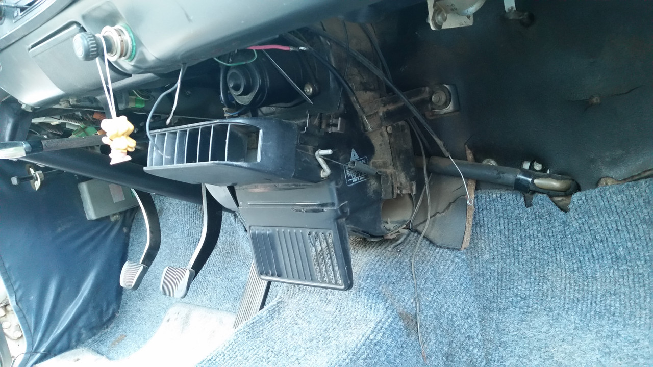

    Now on tot the interior. This truck comes with a heater in the cabin. I would like to remove it:
    1 because I would never use it and 2 I would like to build a box to place the radio head unit in that space. It looks something like this:[​IMG]
    It has a pipe that comes from the engine and goes throw the bottom of the heater and exits the cabin back to the engine compartment. Can I remove the heater with out removing the pipe?

  8. twizted1
    twizted1 Addict
    Apr 2, 2010
    879
    49
    NORCAL
    '89 xcab 2wd
    sits nice!! i dig it with the whitewalls

    Yes just remove the hoses going to the engine reroute the hoses so they feed to each other or follow them and block them off all together. Theres 1 electrical connector? The 2 vents going up behind the dash to the windshield, the 3 cables For the controls and 4 bolts.
    Be warned, youre going to lose coolant. Drain it then make the changes

    what size tires are you running? on 14s?

    @jetas I have to remove the pipes in order to remove the heater? The pipe is part of the heater. Right? I was trying to avoid draining the coolant and removing the pipe. I was hopping to just remove the heater and leave the pipe in there.
    @twizted1 These are the tires I got:
    COKER CLASSIC - NOSTALGIA RADIAL WHITEWALL
    165R15 - 2 1/4" WW
    twizted1 likes this.

    If you're taking out the heater - the heater core connects the IN and OUT of the coolant entering the cab...so in order to remove it you have to drain the system...or not and let it spill all over the place :)
    Personally I don't see why you want to remove your heat on a street vehicle even if not used much. I can think of some situations where it might be handy...like at night...or more specifically when escorting home a woman at night. Gotta remember a desert is hot in the day, but at night.....
    I want an aftermarket stereo in my truck, but plan to make my console sit snug up against the heater, in front of the shifter. There's a decent amount of room there, perhaps you can figure out something and still retain your heat....unless you need to strip all your truck's weight for racing purposes :)

    Rubber hoses run from the engine thru the firewall and to the heater core. Drain the fluids and remove your heater

    The console that turns the heat on and off is broken and can not find another one. I mean its fubar there is no repairing, so I want to remove that whole piece and replace it with dials. And at that point the heater would just be dead weight. And there is a lot of room there to place a radio and some cup holders.

    Thanks @Perkolator. I want to throw the whole assembly thing out. I need the plastic face plate and the controls are all rusted and in bad shape. I want to close off the cabin is extremely drafty and it heats up bad. If I drive it for more than an hour or sit in a drive throw my left keg is on fire, it gets so hot. And the cabin it self it becomes a sauna, in the California temperatures it gets a little uncomfortable. And I'm being a huge kid cause I want the room for all the dials and gadgets. :headbang:
