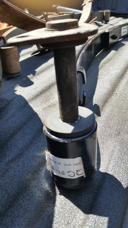

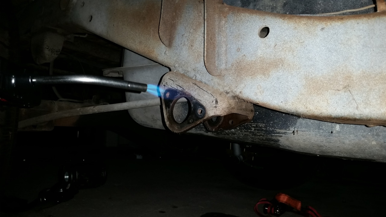

    I have had some time to work on the truck over the past few weekends. I was able to get the rear suspensions changed out and lowered a bit, but not with out some hiccups. First I started out with not being able to get the U bolts out :brickknock:, I sprayed them with PB blaster waited for a bit and tried it again still wont budge:verdict_in:. Went and got a bigger wrench a (breaker bar), cause if one side was going to be this tuff so then would the other side as well. Then came the part of banging the bolts out of the leaf suspension:mad:. That took a couple of hours and a half case of beers:doah:. Eventually they came out, I ruined 3 out of the 4 bolts banging on them so much. Eventually I figured out that I need to place the jack under the leaf spring to release the tensiono_O. That was day one.
    Now time to install the new leaf springs. Unfortunately I can not cause the bolts don't match[​IMG][​IMG][​IMG] . In the rear of the leaf spring the bolts fit, but in the front they do not. Now I have to go hunt for bolts big and strong enough to handle this. Found some bolts at Orchards Hardware, right size and length. Got under the truck and the bushings of the leaf springs do not fit in the bracket of the car. Need to widen that out a hair its gripping the rubber bushing when forced in there:duh:. [​IMG] Went and bought a torch, heat and some hammering then wedge that sucker in there. Day 2 done.
    Then I finally installed the springs brackets and spacer[​IMG] . I did not pay attention to the bracket and installed them backwards cant fit the shock on now:duh::brickknock::mad:[​IMG] . Well undo the bolts switch the brackets from left to right and have the shock connector face the right way. Can't get the bolts out cause, well they were ruined when installed and uninstalled again. The thread on the bolts was destroyed by the bracket. Cant get them out, had to go get a cutter. Great:duh:. Bought a cutter, came back, cut the bolts out switch the bracket re install new bolts wrench them tight again:looney::brickknock:. Finally installed the shocks day 3 done, to dark to do anything else. But now I have this great cutter and new found anger for my lovable freaking truck. So I decide to cut off the bumper[​IMG] Bumper gone.[​IMG] Day 3 done.
