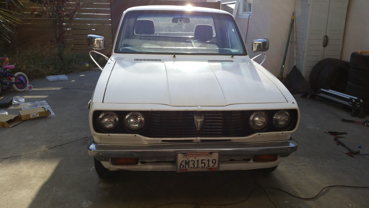

    +1...much better all blacked out....i laughed at the masking sheet behind the grill, person with glasses on. looking out. lol

    Thanks guys. I want to do the same thing to the rear lights. The plastic piece that goes around the light it self. I first need to find a new piece cause the ones I have are broken.
    @twizted1 I was laughing at that to. I only noticed it when I took the pic, that was totally unintentional.

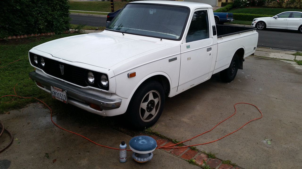

    Got a chance to work on the truck today for a bit. Gave it a good wash, then I used the clay bar and took out some water marks and imperfections in the paint. Left the rust and some of the big scratches ;) it gives it character. Afterwards, I buff it all out now it looks a little shiny. Got the bed rhino sprayed on Thursday.

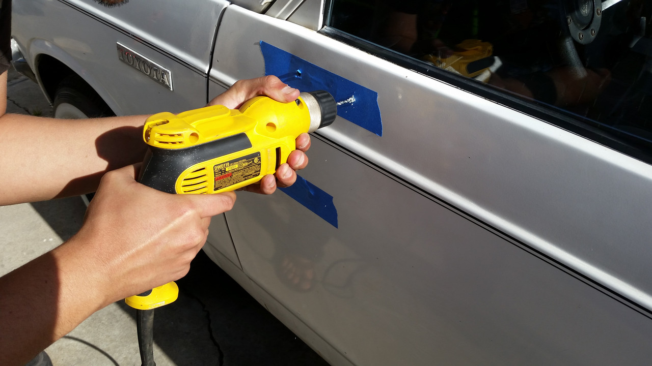

    A little update from this today. I got a chance to add the rims and tires as well a s the mirrors.

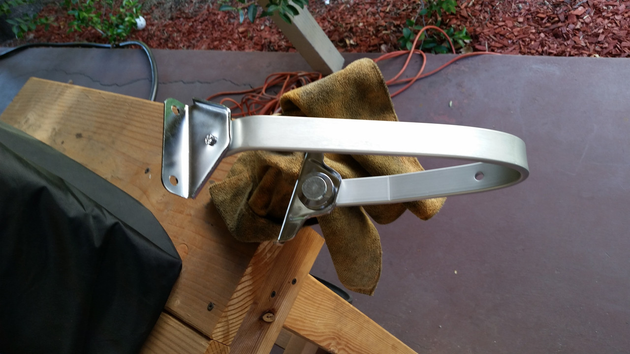

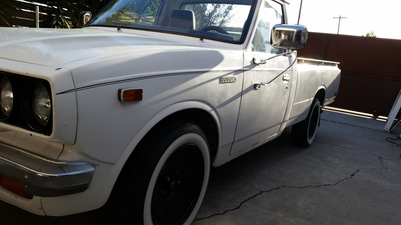

    This is how he sits right now a little high but the white walls give it a nice old school look. The mirrors are form a ford F150 they were really big and did not want to fit in the original wholes I had on the driver side door. So I had to bend them not only the L arm but also the brackets that connect to the door. Those were really a pain to bend.
    Once I got them mocked up to fit in the original wholes I set my marks and drilled wholes.

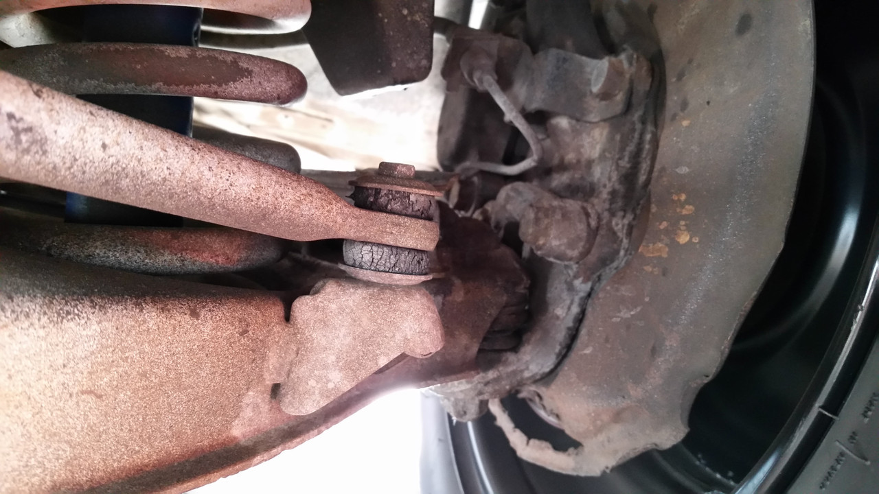

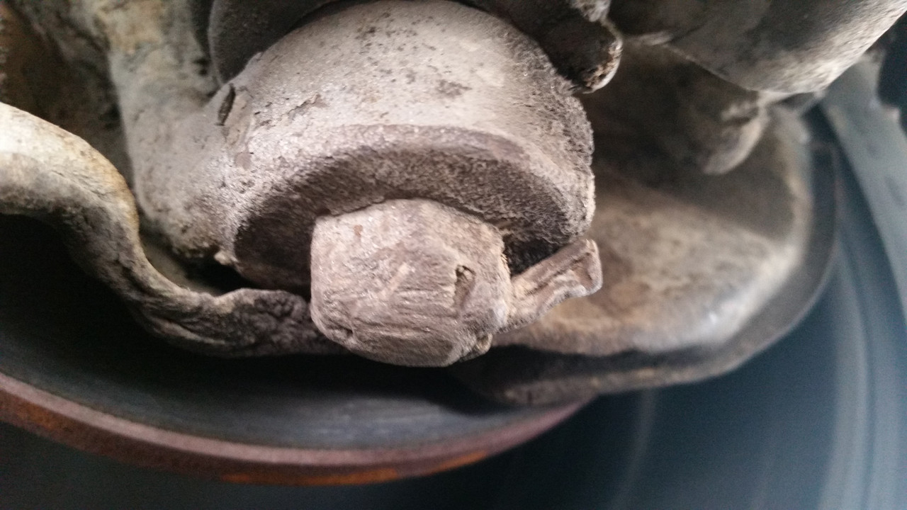

    Then I planned to lower the truck I got shocks and springs all around but as I took the wheels off and inspected what I had to work with I saw this monstrosity.
    This is the passenger side lower ball joint, lower bolt. Apparently it has been hit and fused together. I can not even pull the pin out because its totally fused in with the bolt. The bolt has no sides to grip a ratchet. I have no idea how to take this off???? I have also noticed the boots of the ball joints are also worn and broken on the driver side as well. So I have to order new one of those for top and bottom both sides. While I'm there I might as well replace these:
    What are these bushing called? When I search sway bar bushing it only shows the middle bushing and that is not these. So that was my progress so far for this Saturday 2 out of 3 things got done. I really wanted to install the suspension but the ball joints really put the brakes on that. If you guys can give me some ideas on how to remove that fused bolt I would love to hear it.

    Is it just crud built up on the ball joint nut? Pick at it and see it anything comes off. Mines were covered in crap.
    Otherwise just order a new BJ and cut that bish out.

    They are called end links or stabilizer links.

    When I saw the pic of you drilling the doors I was immediately like "AAAAHHHH!!!"
    As for the BJ - looks like someone drug that thing over something a few times, lol. I'd take a grinder/cutoff wheel to it - maybe make the bottom of the nut flush to remove all the "fused" section - then soak it in penetrant and take a vice grips, pipe wrench, channel locks, torch, you name it to try and get that thing off. If not, you can always try and split the nut with either a nut splitter tool or make a groove with grinder/dremel and use a cold chisel in the kerf.

    Looking back at your last 2 pics - looks to me like someone was driving and the wheel fell off....based on seeing all the drag marks on that BJ nut and kunckle + the worn through backing plate.
    Must have been fun times when that happened! Happened to me once on a lifted k5 blazer with 35" tires - I think someone tampered with my lugs while at a party. Good thing I was on a side street doing 25.

    I want to finish the exterior I'm almost done. All I have left is to lower it add the tint back on, the first tint the back was to dark could not see out of it at night and the driver side door ripped the tint of the window when I lowered the window down I have a nasty bend in the window track. I also need to change the rear lights the plastic piece is torn and broken got new light but they are grey so I need to paint them and reinstall. I got the rear lights at home, and one of these weekends I will change it. But first I want to lower it. I'm going to read up on some of the posts on here from other people that have changed the shocks and springs. I have some questions regarding the process. I'm going to use a nut spliter to get rid of the road rash bolt. I need to replace all ball joint top and bottom on both sides. So any stubborn bolts I'm just going to split, I don't know if I will have access to a cutter.
