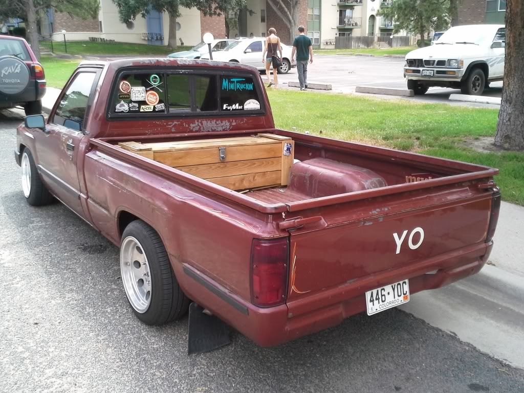

    Here she sits outside my apartment. Not too shabby I think. Delayed my sub at jimmy johns because the dude couldn't stop drooling over the engine. A little part of my wants to leave the hood off...

    Taking pictures of the truck or the girl in the background? lol

    Woops, didn't realize those people were there. She's a bit too skinny for my tastes anyway.
