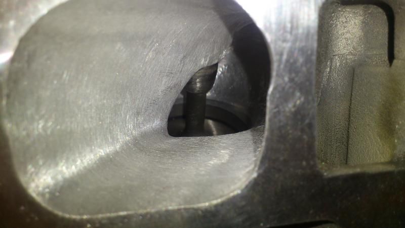

    Well I have been working on the head and I am very happy so far this sucker will flow kinda excited woot woot pic soon

    Well here are some pic's, I am far from done. I think i have taken just about 1/4 pound out of it
    this is still a rough cut. I must say the 22re head is **** tell it is ported
    ps photos are bad but I am working

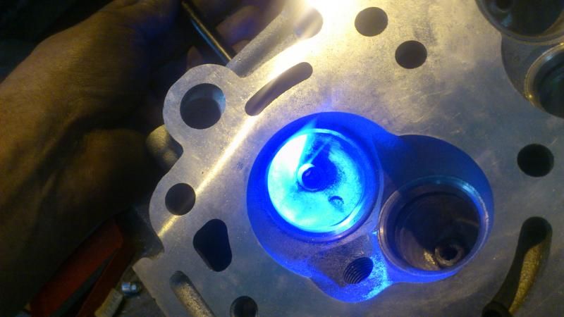

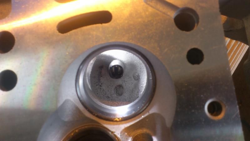

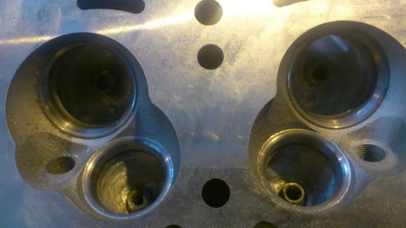

    Well still going and I forgot to add these photo's
    Pulling the motor for a re-freash and replace the stock iron rings with molly rings
    Head work
    The exhaust valve has been lapped in and notice nice thick contact area for better cooling where as the intake being smaller for better flow
    Just about done
    Next on the list is to re shape the Chambers a tad "taking off the unwanted sharp edges and what not"

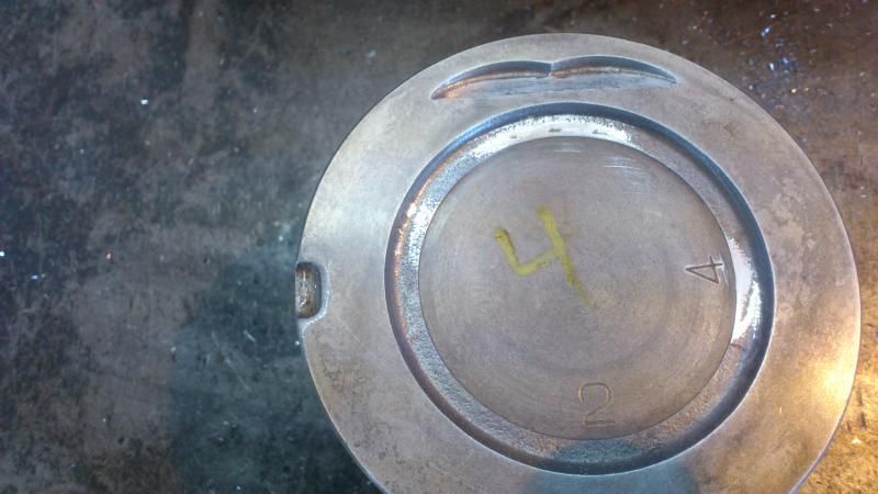

    Turn out I have 3 pistons that look the same and one odd ball I am not sure why since they all show the same amount of ware ??????
    and who replaces 1 piston or replaces 3 and not all 4 ??????????????

    pic's of pistons
    what one is the real deal

    Right is stock, left is factory replacement.

    Haven this one odd ball piston bugs the **** out of me and its not the same weight eather why on earth whould you go after market at lest buy a factory one
