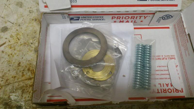

    my lsd max grip rebuild kit came in today got the last one in stock to he says it's hard for him to keep them on the self's

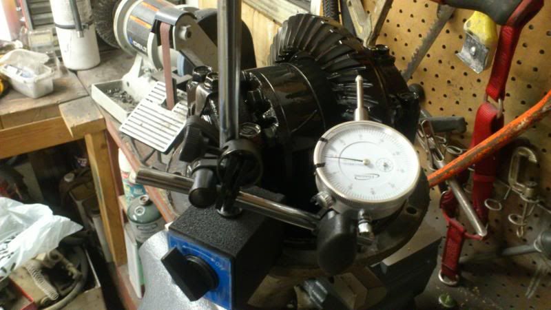

    Well I installed the new Weir performace max grip kithttp://www.weirperformance.com/maxgriplsdkits.html and wow this truck just got even more fun to drive no more second guessing rear end if it's going to lock or unlock.
    I really should have done this sooner can't wait to try it with the beat meats going to make this truck alot more fun and easier to race around the track.
    Only bad part is my gears are worn and I don't have that great off pattern cause frankly did not care at this point since I am not sure what ratio I may going with next ???
    But it's setup right now at 6 thou but could be deeper for the pinon side of things
    [​IMG]undo one ebrake cable and just pop the shafts out and theres engough flex in the brake lines to do this with out un-doing brake lines
    10 thou of back lash that means the crush sleav has moved on me and teh gears should be raplaced cause they gave an odd pattern

    All miced out time for the hat test
    Hat test was good time to put it all back together had to remove some shim's
