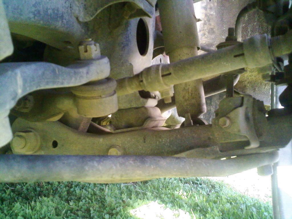

    ok finally droped it but it seems like it rides really rough lol front is sitting on bumper stop and back i took them off, but wouldnt it ride better if if put low pro bump stops on front and back and some drop shocks? I did 3'' block in the back with middle leaf taken out and the front i turn the torsion.. but anyways here some pics

    you trimmed the fronts right?
    and flip that rear brake lever thing

    CIN: I didn't trim the front it's basically sitting on the rubber and the back i didn't flip the brake either, should i? Also unno if you notice but i took ur advice that you gave somebody on toyota nation or yota tech in reusing the leaf positioner on the top of the block, does give extra drop :D

    sometimes you just gotta listen to the asian! j/k if you remove it, you lose about 1/4-1/2" of drop.
    I'd recommend flipping that thing. you literally just push on it hard enough so it goes down lol. if its up higher like you have it now, it thinks that there's a heavy enough load to push the truck down that much.

    LOL! once i paint the outside white, next step would probably be the interior, reupholstery, but hey did you take the bump stops on the front of your truck? Mine is sitting on the bump stop and it rides like a bull lol i passed the railroad tracks when i first test run it with the front drop to bump stop and man it almost felt like the truck was gonna fall apart lol going bout 25 miles per hour.

    you literally slammed your truck on the bumpstops....
    My setup up front is trimmed bumpstops...
    and about 2-3cm between the frame and bumpstop, so i actually have a slight bit of travel :D
    And trust me, I rode on bumpstops for over half a year and all that.
