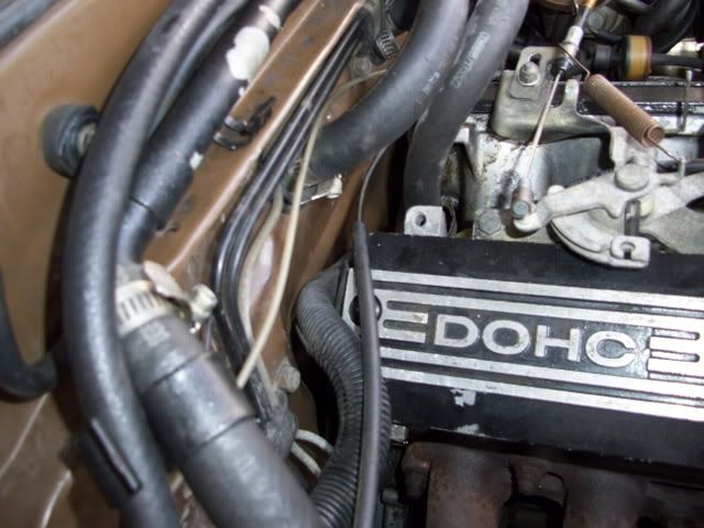

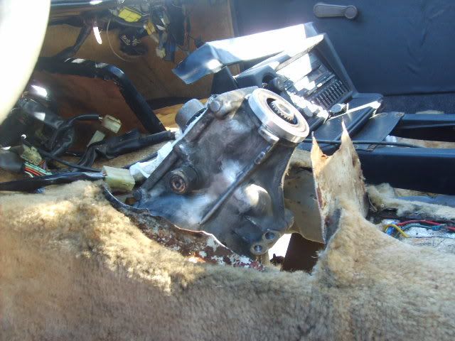

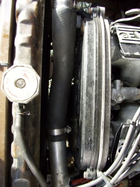

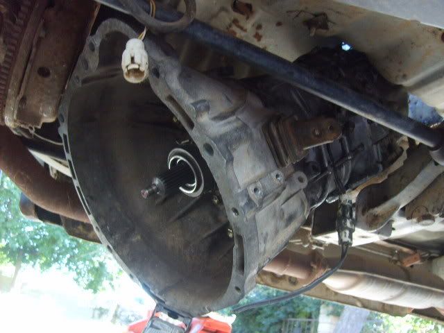

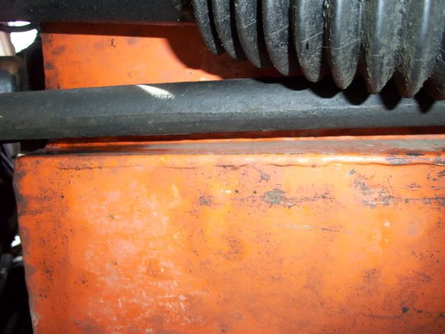

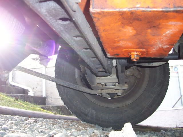

    Here are the pictures I just took It will give you an idea of how tight it is.
    from above
    At the firewall passenger size
    rad support
    steering link to pan clearance 3/8" at best with custom pan
    front of pan
    rear of pan
    and cross bar clearance

    WOW!! thats tight...

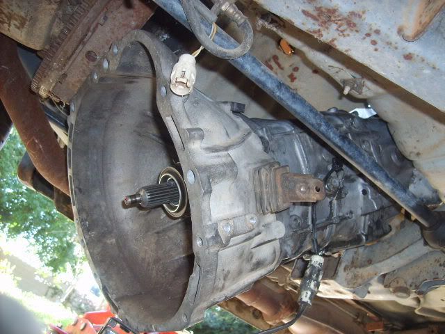

    i tried to stick the trans in today, its not going to happen easily. i will have to either window the trans tunnel or lift the body off the frame a few inches to get clearance. i will have this done sunday. i like that oil pan. i have a stock pan and the drag link for the steering was modified from a ford econoline van.

    the trans is in, this required some surgery. and a lot of bad words. just a bit of advice, i dont recomend ever channeling your body. it makes an easy job near impossible.

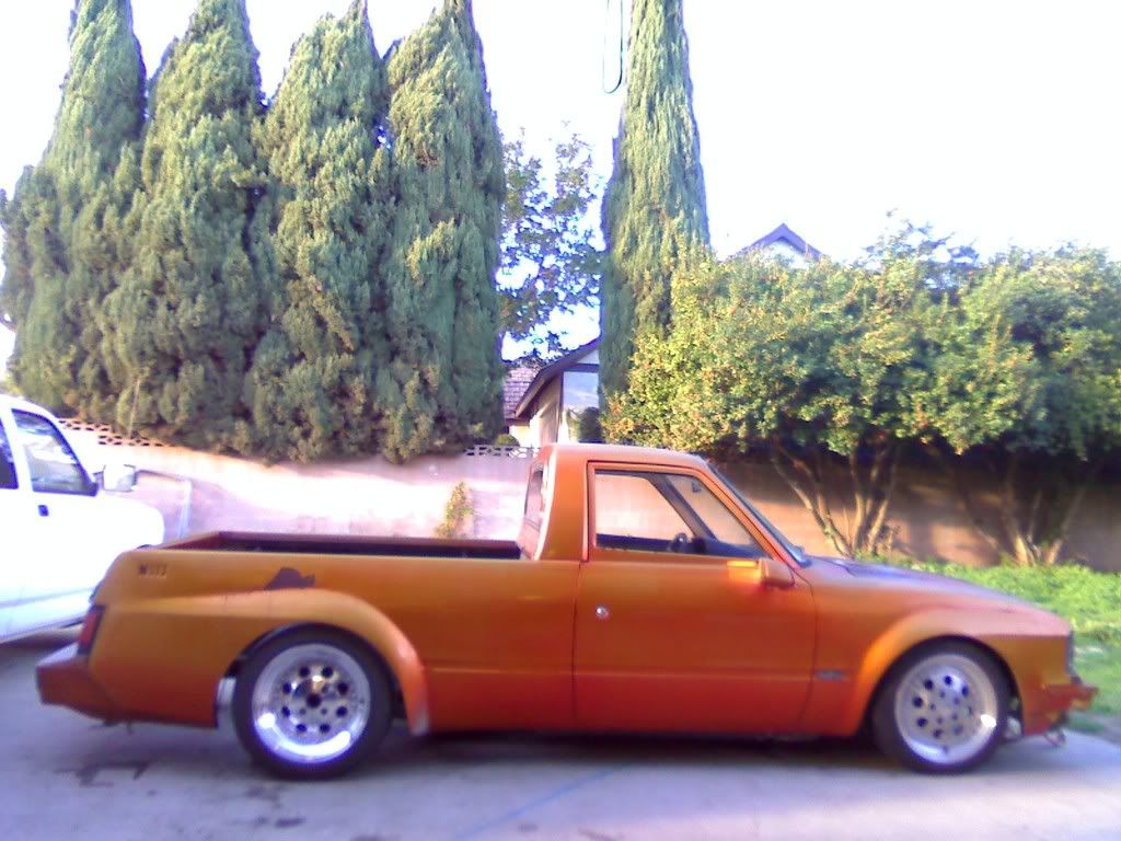

    i got a little more done. lowered it some. just need to repair a few wires that some rodents have destroyed. next i'll have to get the rust out of the fuel tank. [​IMG]
