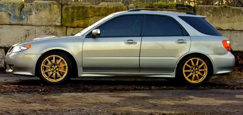

The Brembo's are hella expensive from the Subbie community... It took me 4 month of searching to find this set and i think i got an ok deal... Here's my DD I convert the fronts to the Brembo have the rears as well but just need a $200 bracket to add them as well.
