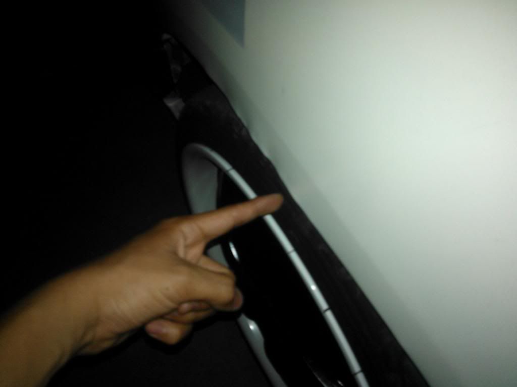

    It was in an accident but not a major one the fenders are good bearings are good nothing looks twisted either il post some pics as soon as I can and it is the front tire

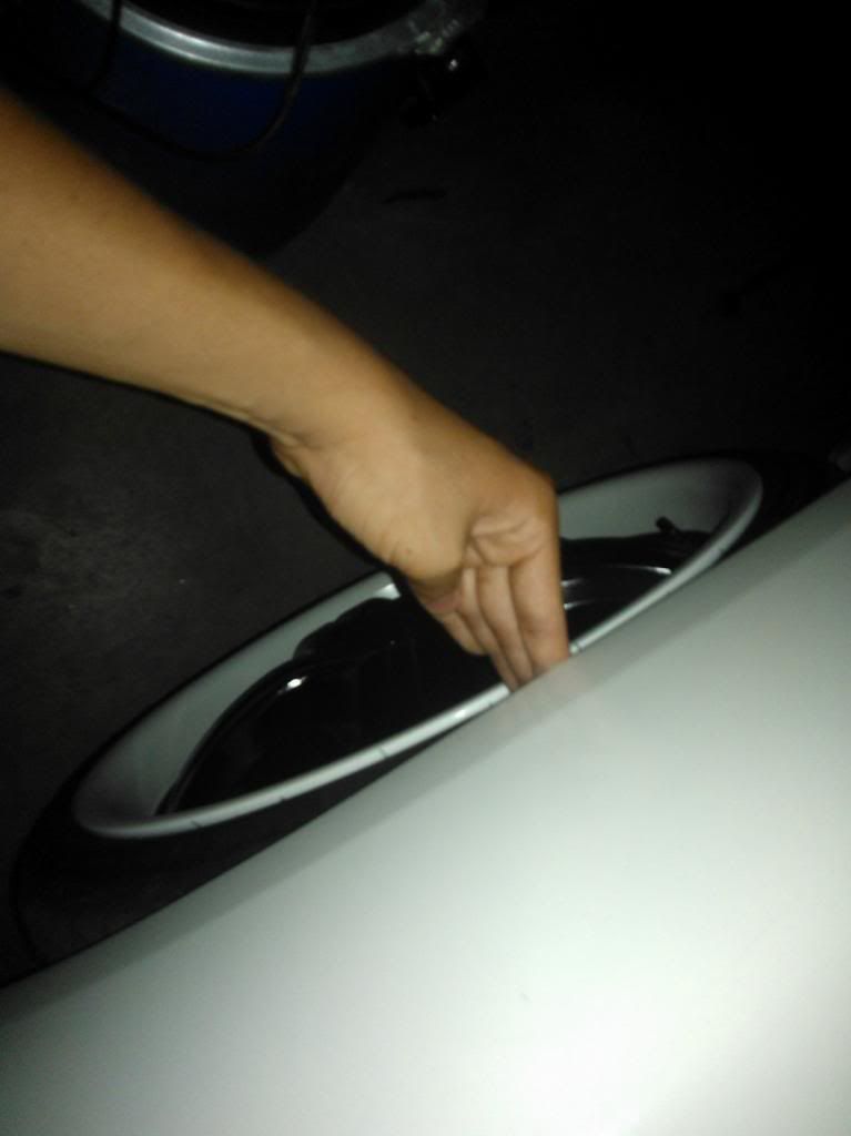

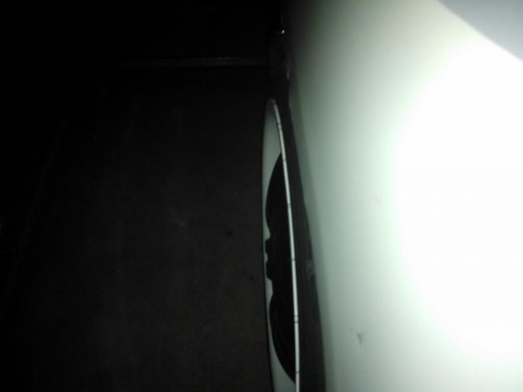

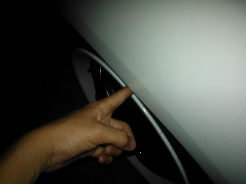

    pics of tires
    here are the pics idk if there good enough to see wat im talking about
    the first two pics are the ones where the wheel sticks out and the bottom 2 are from the tire being in

    it doesn't have to be a major accident to cause that much shift. 20-30mph is all it'd likely take in the right spot. My body has what I consider a slight 'lean'. Even though it looks mostly good (other than being old and having flaky paint), if you start measuring everything up, the body leans by about half an inch at hood height, and nearly a full inch at the top of the windows. Nothing will look twisted or out of place, and all the body mounts to the frame are still right, but it will be 'off' by a bit the farther away from the body mounts you get. A half inch at hood height is still only a few degrees of lean. Barely noticable without math or careful scrutiny.
    The only evidence of the crash I could see was the front driver fender was crunched in a few inches and had started rusting. Even though it looks back to normal with a new fender, everything takes just a little more work to fit back into place.
    tl;dr: It don't take much to screw up the geometry of these trucks.
