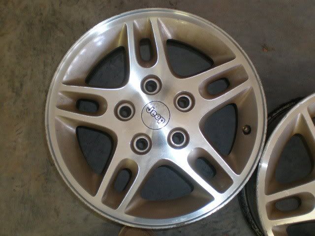

    na, i picked up the 16 inch 2000 jeep grand Cherokee wheels, i have a plan for them if i can get them to fit...lol
    The guy took 30$ for the set, its not like I'm at a loss if they wont work.
    There is a guy at work that will give me 60$ for them for his trail jeep.
    Going to paint the gold areas black on them and change the center logo.well see...
    If you had not noticed....i do things a little different then most...lol
    they look like this.

    I'm still trying to figure this out...:brickknock:
    I honestly have NO idea what I'm doing here...lol
    I know all the numbers now, but its still all gibberish to me.
    Toyota numbers i know are....
    size 14 X 6, bolt pattern=5X114.3 bore=60.1
    and the jeeps are
    size 16 x 7, bolt pattern=5x127.0 bore=71.5
    I have NO clue how to figure the adapter thickness, but have found a few deals here and there.
    Give above info, I know I need 5x4.5 to 5x5, but don't know how thick they should be, how do i figure this?

    the rims are....
    Backspacing = 6.0" Offset = 50.8mm Bolt pattern = 5x5 (5x127mm)
    What are your adpters and will they work with this?
    What will i need if they dont?

    Ok guys, i think I'm figuring all this out...lol
    with the jeep rim at
    Is there anything i can get to make them work, or are they just not going to fit?
    Ive see to many conflicting #'s now to know...lol
