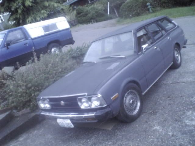

    a 70-77 toyota corona station wagon has the exact same suspension as the same year's hi-lux
    The complete story:
    where it sat for 10yrs unmoving in 2006
    i ended up paying the guy $50 his story was sad...
    bought it in '96 to tow behind his RV. never took the RV anywhere. sold the RV in '00 the wagon just sat. i left 3 notes then knocked on the door and talked to the wife. had it 3 days later.

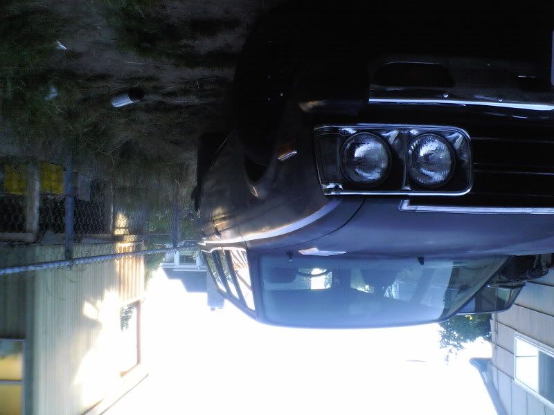

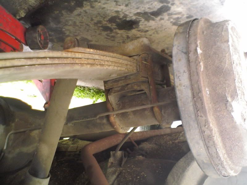

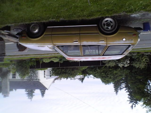

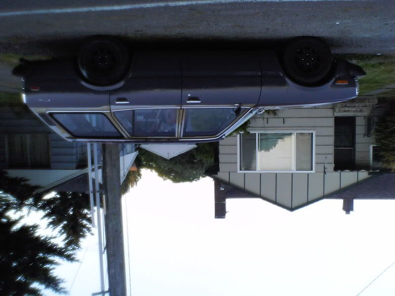

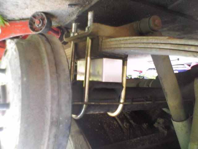

    a good couple baths and some shop rollers, believe it or not it started with a lil brushing to the plugs and some fresh gas
    lowered the back with some blocks...
    lowered the front with some heat (note: DO NOT DO THIS it is extremely hard ta keep the car/springrate level. dont be a lazy ass like me and jus take the springs out and chop em) got some better offset rims for clearence

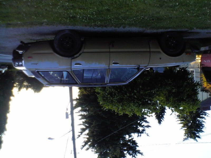

    then i went to the junkyard and for about $120 i got a new: head liner, fender, chrome roof rack, back door with wiper, missing botom chrome strip, brake master cylinder and a new tail light housing with no dent
    and now some spray paint...
    a lil more and
    voila

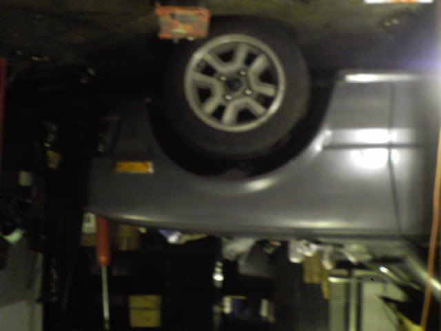

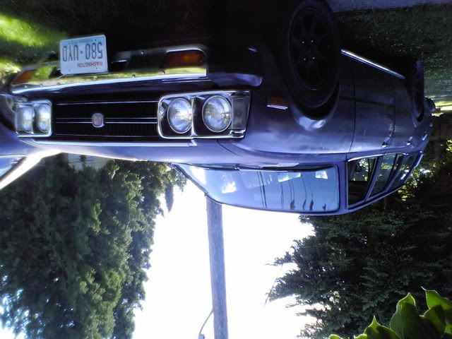

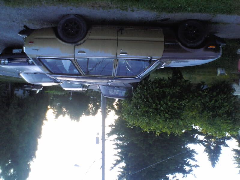

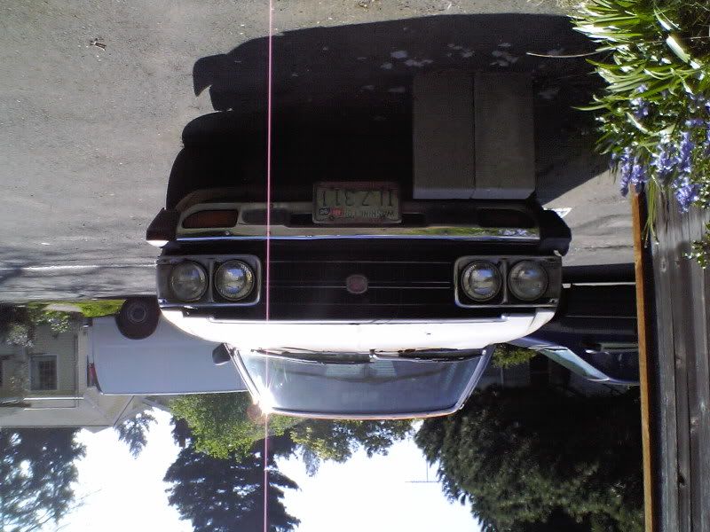

    so i came across some cressida rims on craigslist for $90 with some "ok" unmounted used drift tires.
    b4
    after
    side shot
    and it got a little lower bout 1.5in so i took a pic with a 20oz coffee cup. the same cup fit under the car with the stock style steelie's
    turned out that these gold rims were bored out to fit on a 240 so the center caps wouldnt fit, i got new rims minus the gold and boring. they came with huge tires on em that were far superior to lil tires on the gold ones plus i sold the gold ones and tires on craigslist for $150.

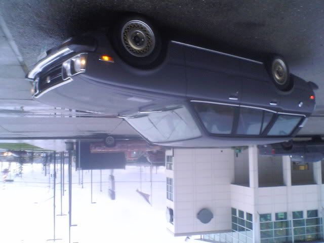

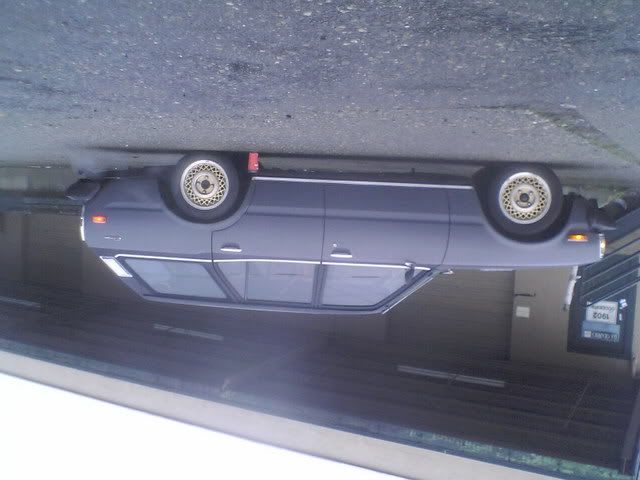

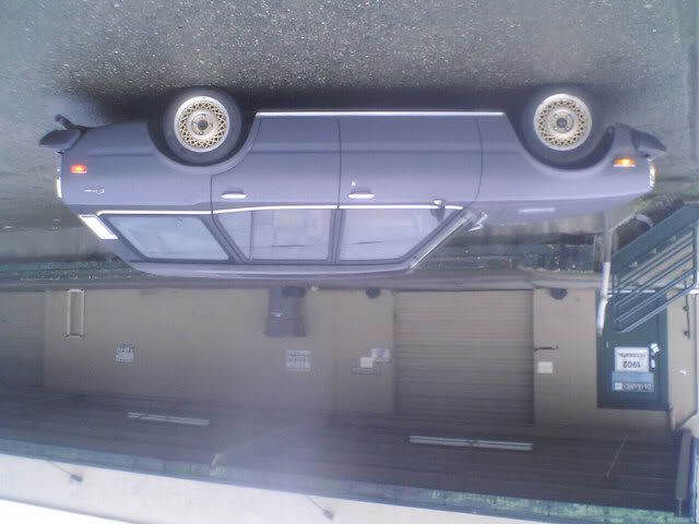

    now ive got mixed offset supra rims on it.
    14x6 on the front
    14x7 on the back
    all thats in honor of the supercharger swap.
    artist rendering

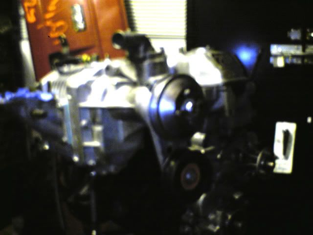

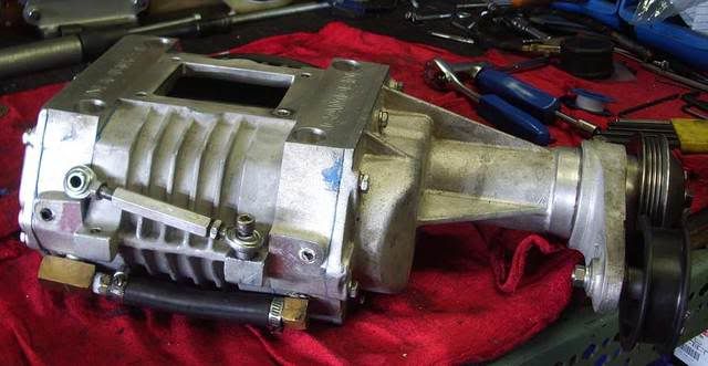

    what its getting:
    22r head with a 20r block
    camden 5in supercharger
    weber 32/36
    5 speed swap
    power steering swap
    i got the LC kit used for 1k had it refurbished for $500 @ camden.
    mocked it up tonight no bolts in and a bit of cleaning to do,better pics with more light soon.
    another week or 2 and ill have video of it laying rubber

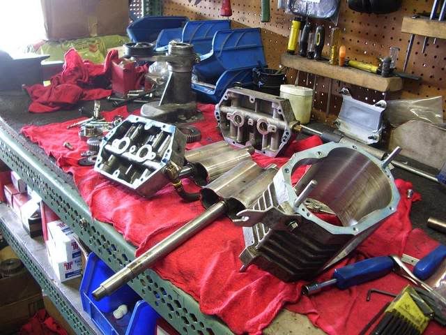

    thought i would bump this as ive been a busy beaver lately...

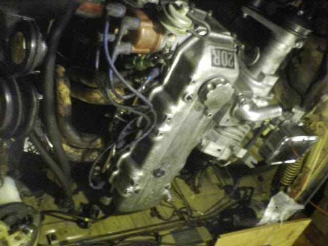

    the new heart:
    20r block with a 22r head
    auto to W58 (supra) swap
    camden supercharger @ 7psi
    weber 32/36 (for now)
    electric ignition and fan
    SACHS clutch
    its in and fitted, i just need to wire it up and run the exhaust.
    it also turns out that this setup is a F load lighter then the 18-rc.
    b4 w 18r-c and a A42 slush box (80% cast iron)
    now with 2XR n W58 (30% cast)

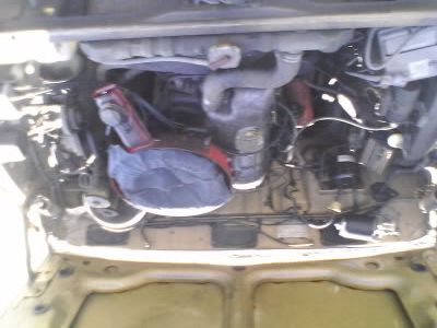

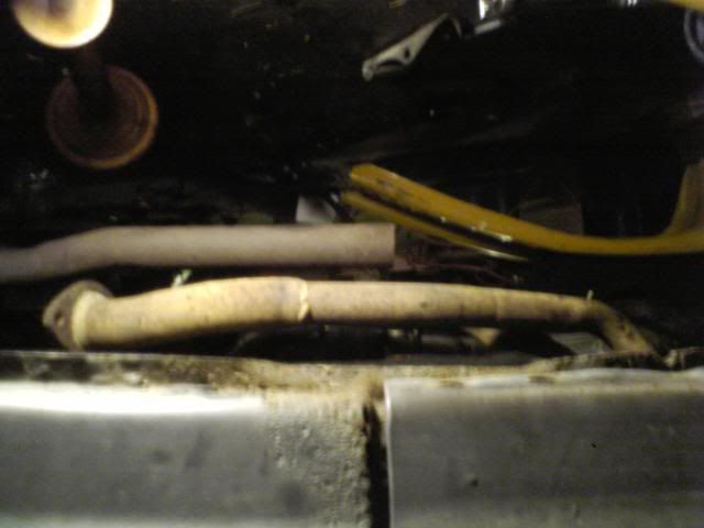

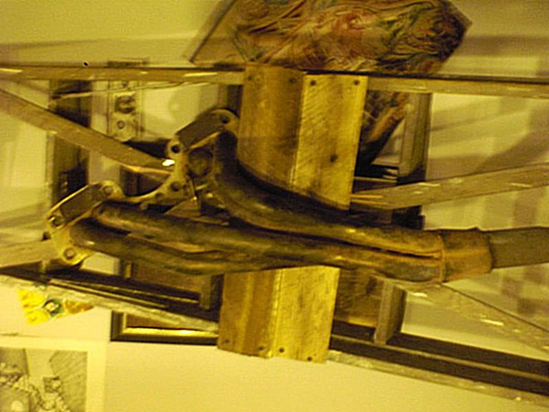

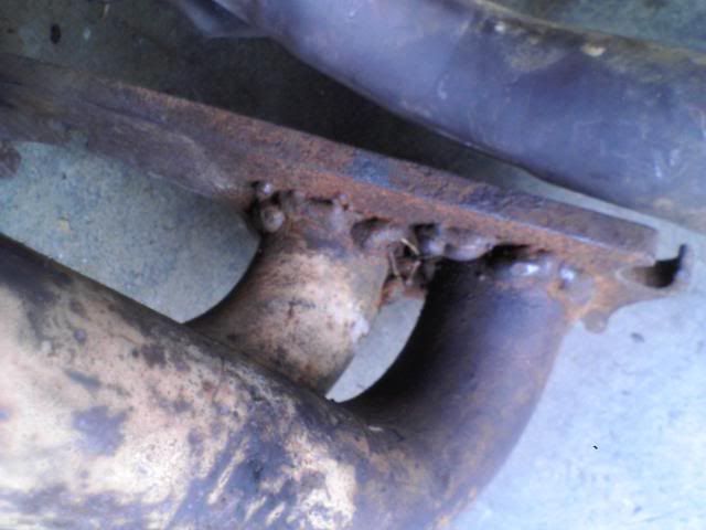

    i managed a decent pic with my camera
    have the uglyest header you have ever seen on there for clearance issues. i did not do these hidous welds, this headman was attached to my wheelers new body, and somebody raped it with a stick welder on high.
    i tried to use the 22r cast tri-y manifold but this is how far it stuck out below the body line
    i needed something in there i wouldnt beat up and would work for now, i need all new exhaust. i plan on dropping the front more then b4 for a more aggressive stance. now i think it make the SC bling a lil more, just hope i patched all the holes:D

    Hey, thats looking pretty good. Im likeN' the new additions, that thing is going to rock. Im withya on the welds, those kinda scare the hell outta me, functional for mock-up but, definently a scary sight. Hella nice work, cant wait to see more . . .

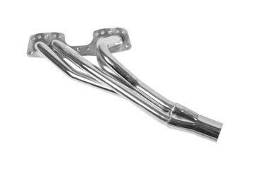

    getting ready to turn my old header into a bottle rocket launcher cuz i got a new doug thorley from a internet dating service...
    online profile pic
    when it showed up at my door
    dosent matter tho... id still hit it:D
