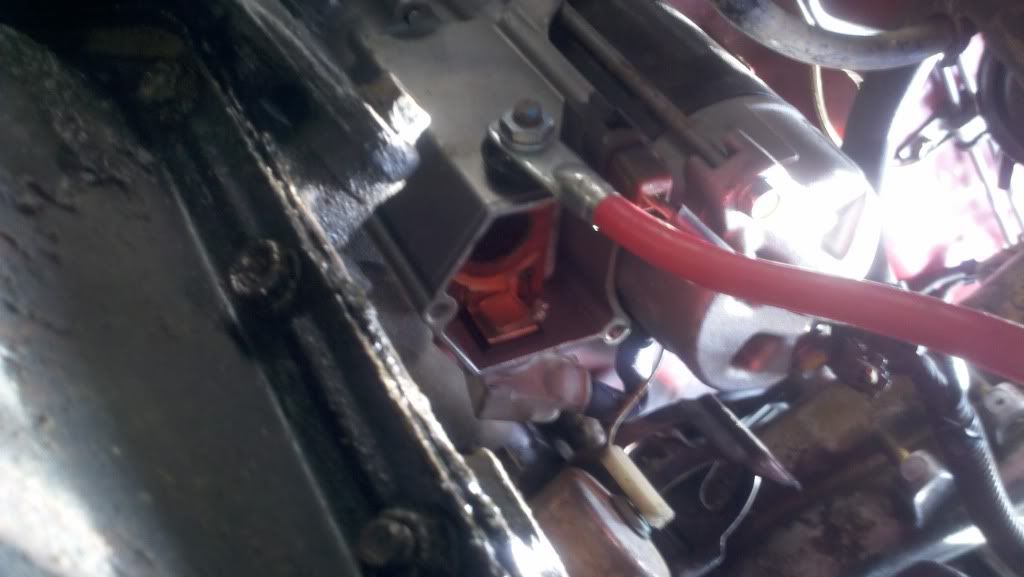

    i had the same problem on my 4x4 and gary (truckaction) showed me how to fix it. the problem is the starter trigger wire gets old and gives a weak signal.
    to fix it you install a ford starter solonoid (about $12) in line with your battery to starter cable. then cut the stock starter trigger wire, and wire it to the small left post on the solonoid (the one closest to the battery cable side), then run another wire off the small right post to the trigger wire terminal on the starter. i haven't had the problem since :)
