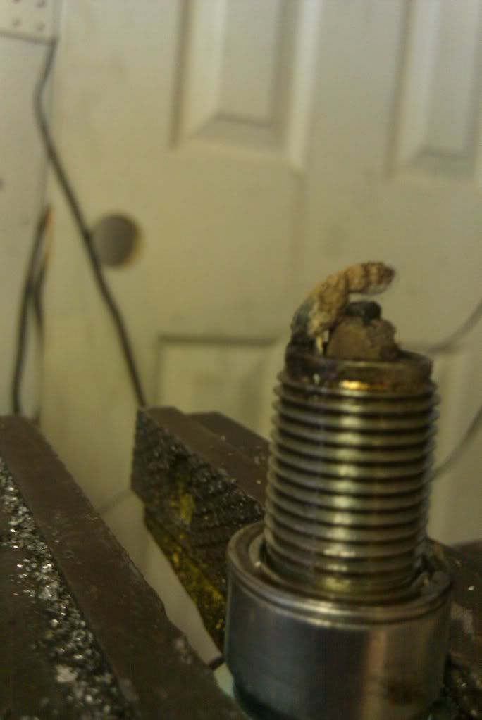

    Well i took it over to my friends, and after a little investigating, the cat is going out but we moved up the line, and found this spark plug [​IMG]. This is out of the #1 cylinder and from what the manual, it said that I have worn valve seals.:( So ya, joy.
  8. IronNam
    IronNam Grand Toyotaholic
    Sep 11, 2008
    6,960
    Kansas -> NorCal
    94 XCab
    looks disgusting!
    man, hope its not that bad..
  9. Ace
    Ace Member
    Aug 16, 2009
    53
    Ya me to.:brickknock: I'm going to have my auto teacher look at it to. Right now i changed the plug and put in some oil treatment so its drivable.
  10. SD YOTA
    SD YOTA Grand Toyotaholic
    Jan 30, 2007
    3,585
    30
    san diego
    2000 Toyota Tacoma 2wd
    swap the plugs, make a test pipe to replace the cat and run a heavier oil with lucas oil treatment. should give you a bit more umph and keep it from burnin too much oil.
