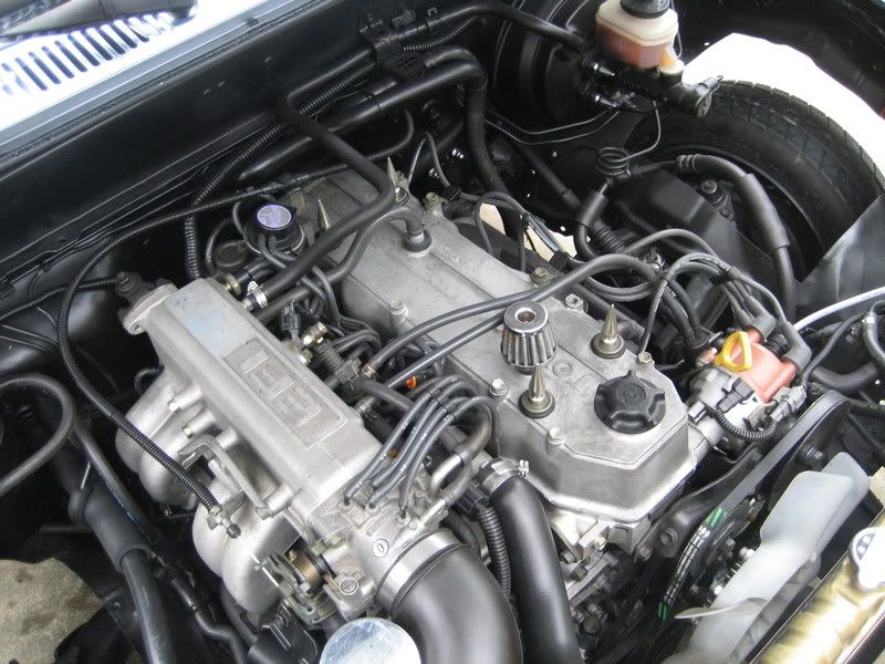

    Here are some pics of what I did on my 91 with the 22re...
    As you can see in the pics I moved the battery to the bed of the truck to free up some room. You dont have to do this, but it makes things a lot easier to move around/relocate! If you have any questions about something feel free to ask & Ill be glad to help.

    Thanks Donny. Is there a bracket under your afm?

    Believe it or not, but no. Ive got the hose clamps so tight that it doesnt move, but I also have a hole cut out in the inner fender that if you look real close youll see. The filter sits in it helping keep it stable & getting more air too!

    smctoy does ur intake suck in water when it rains? Its cause u made a hole on the inner fender.
