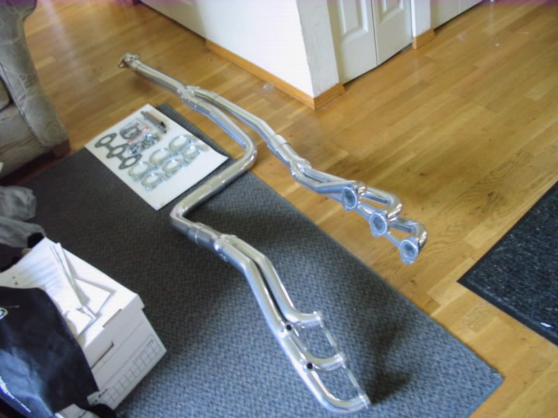

Ive a 3VZE and may be getting a set of Ceramic Coated Doug Thorley Headers. Has any one that's running these headers had any issues with them? Specifically them hanging too low....im baggin my truck in the future. Pros and Cons?
I had set on my 4runner and yes they hang lower then ya like I had to mod mine so it would work with my sas so the exhaust would not hit the drive shaft stock modded all I had to do was was cut up the the pipe to tuck it up higher what I did was cut 1 inc off the passenger side coletor then cut about 8 inc's or s off the y pipe on the passger side then after cutting some pipe off re welded this back on so it could slip over the collector this si what the y piped looked like all welded up and here is the why pipe collector hope this help but yes chopping will have to be doen if you plan to lower it since it really made for a IFS-4x4
Yeah thats what I figured.....cant thank you enough for the pictures...thats really going to help me out. Ive also read that these wont fit on a 2wd pickup because of the torsion bar on the passenger side. Seems like I read a thread somewhere of somebody clearancing the torsion bar to make it fit but I cant find the thread now.
thinking about it it just might clear reason why is they hang to low so it hits the bars the way I did it will fit with torsion bar since ti is sucked up so much
That makes complete sense...ill get up under my truck this afternoon and figure out how to run that S pipe. Again, thank you for the pictures!
