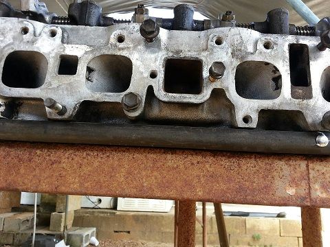

    Any suggestions on cleaning the block for paint and overall clean

    Get it hot tanked. Should knock everything right off and come out clean. Mine did

    ^ yea that head looks gunked up hot tank the block and head and then paint it

    Wat do u use for hot tank lmk thanks and wat do u mix ?

    Machine shop.

    Yea machine shop . They have motor baths that get extremely hot and some pretty wicked chemicals to
    Basically if you have your block torn down and are having machine work done there ask them to hot tank the head and block ..the rest of the motor timing cover and such you can clean up with some degreaser or kerosene and elbow grease engine bay to

    I can't make it out. Did you swap heads and get a cam eccentric fuel pump, or use a regulator off the EFI pump in the tank?
    What controls the distributor timing? How much adjustment did that take?
    Beautiful. I'm jealous.
  15. yota89
    yota89 Enthusiast
    Jan 14, 2013
    212
    guam
    89 single cab
    Nope didnt swap head just cleaned the f**k out of it same cam got an electric fuel pump
    cause i deleted the ecu used the ignitor from the efi got a dis with vaccume adv
    as in adj wat u talking about
