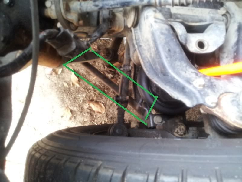

    Okay, quick question... on the lower control arms on my 92 pickup, there is a pair of nutplates mounted on a bar. The bar runs front to back on the arm. This assembly is inboard of the two front/back mount holes for the ball joint. What is this stupid thing for? It is what my bags are rubbing on, and I need to know if I can just grind them off so that I don't have to remove the old bag plates and weld on new ones... Don't have a way to get under the arm to figure this out.

    The bar in the green box is what the nutplates are for... What is that bar, and what is its purpose? Can I just unbolt it and toss it? I notice that there doesn't appear to be any provision for that bar on the djm or cando lower control arms...

    that is your strut bar. it keeps the lower control arm from moving forward and back wards while driving and braking. you have to have it unless you triangulate the lower arms, or run aftermarket arms like cando. his arms are built to triangulate the lower eliminating the strut rod.

    ^^^^^^^^^^ what he said is the truth and those are you best routes
