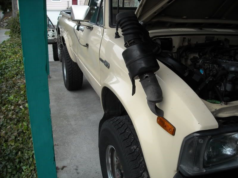

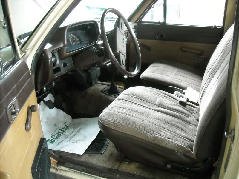

    now im doing a bit of work to a mostly perfect, almost exclusively dealer maitained 82 4x4. the thing is beautiful, all the factory hardware is there, with clean threads, most all previous work was done right with care. this truck is a true joy to work on for a toyota nut.
    original diagnosis was a blown headgasket and a bad timing chain guide, with a possible bad timing cover. i was mostly right.... mostly.
    any ways heres the pics you waded through the text to see.

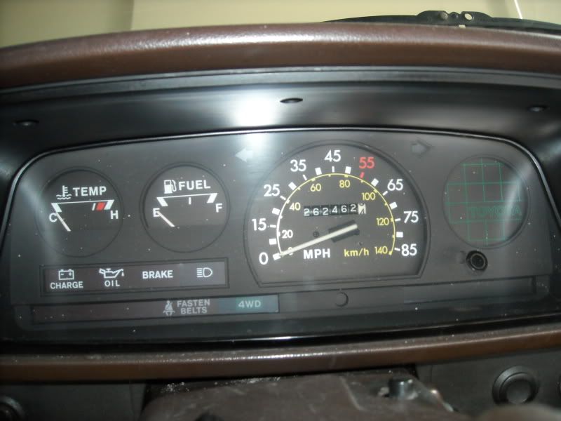

    hard to believe the mileage

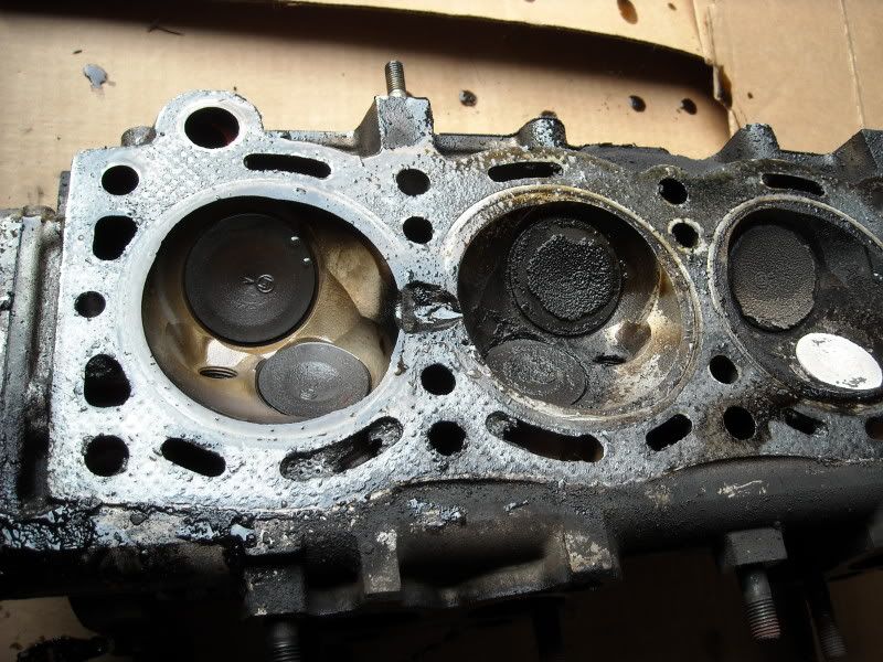

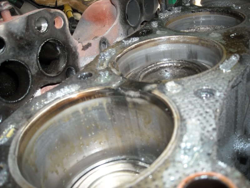

    turns out i was right

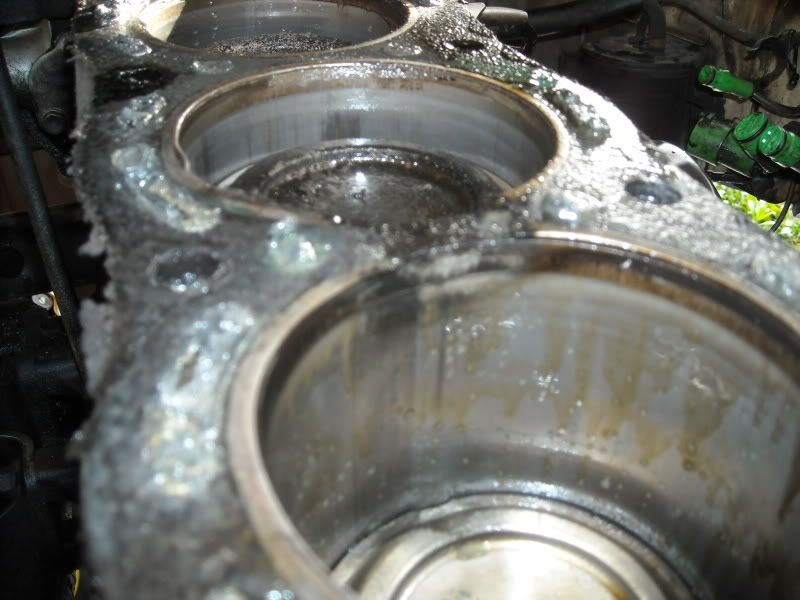

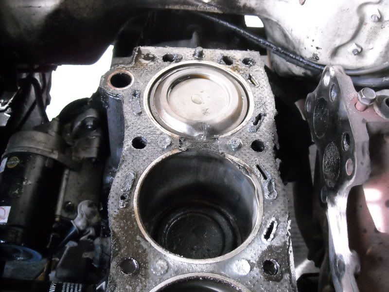

    im a lil worried by the pitting and carbon scoring on the cylinder walls.

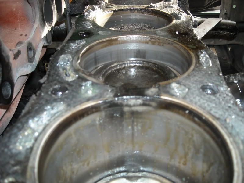

    yep im calling this a junk block
    if you notice the raised bits on the head gasket, thats radiator stop leak, DO NOT EVER USE IT PERIOD.
    oh hey the head is F'd too :cry:
    so the reason i posted this in the build up section is i hope to convince the owner to throw money at the motor the way i want to. i havent talked to him yet since i found out the motor isnt repairable.
    this is a classic example of a simple problem turned bad.
    radiator was leaking, and someone added stop leak, still lost fluid and overheated. new HG on a warped head with a still leaking radiator. and somebody updated the timing chain to a single when this truck came with a dual from the factory. the dual timing chain should still be in there, and good enuff to use on the next motor to live there.

    I say the block is still good... Hot bathe that baby and bore .40 over...
    Yea that head is toast! Brand new/rebuilt heads on ebay 3 bills max. I'd estimate no more than 9 bills just for parts and machining. You can tack on your labor rate after... I'll do it for say 2g's total for parts and labor. Well, worth it to keep that precious thing alive! Good luck! :waytogo:
    btw- that timing set is probably from the '82-1/2 - '84 model... Any other single chain will be too short...
