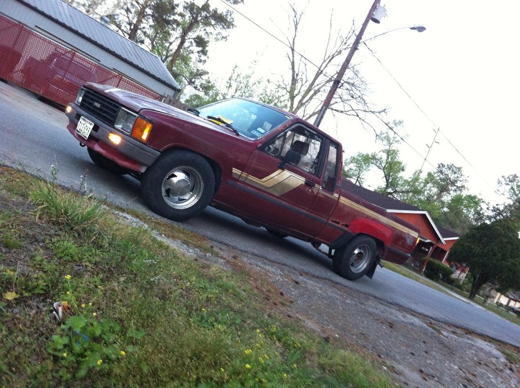

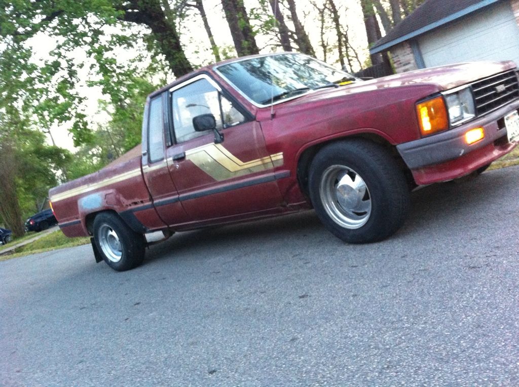

    I just finished installing the 3 inch blocks setup is torsion bars and 3 inch blocks [​IMG][/IMG] [​IMG][/IMG] by the way anybody know what kind of rims are thes i need 3 center caps

    Im not sure about the wheels but there sweeet! Diggin the drop big time!
    Howd u get the bumperlights to light up with the corners.. I just did it wanna know how u did it.

    ya paint them black so no one can see them sorry

    the wheels look like american racing or american eagle.... Tires are a bit 4x4 status.....
    For the one who asked about powering the turn signals, you have to run a power (+) tap from the side markers to the turn signal (+) and you will have them light up when the side markers light up...

    looks like he swapped the plugs between turn signals and markers thoughnow that I noticed the side markers are not lit....

    Could have his hazards on??

    lol yeah hazard lights on but i wanna make them turn on with side markers, also the tires are gonna be smaller, or get 15's nd smaller tires ;)

    Yea i might just paint them black

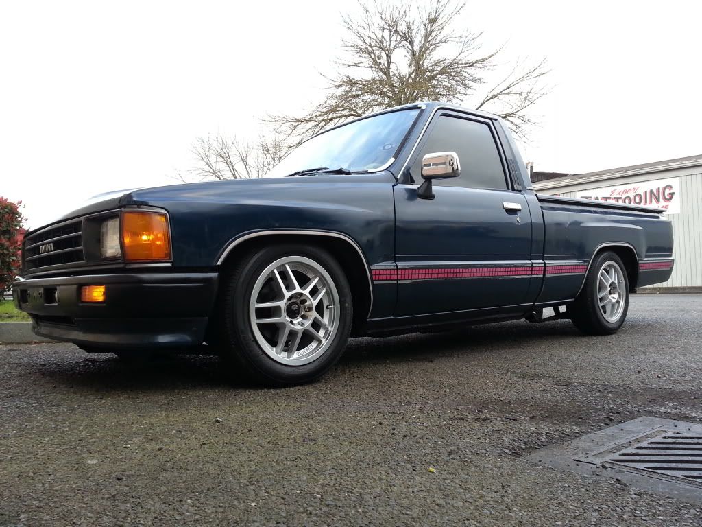

    I did a small simple wright up on adding a light to ur bumper light. Running apower wire from corner to bumper is easier but I like the two bulbs look.
    Picture included to make u want it more :waytogo:

    Thanks ill have to do it when im not doin nothin else to the truck haha
    Nice truck bro
