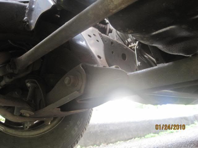

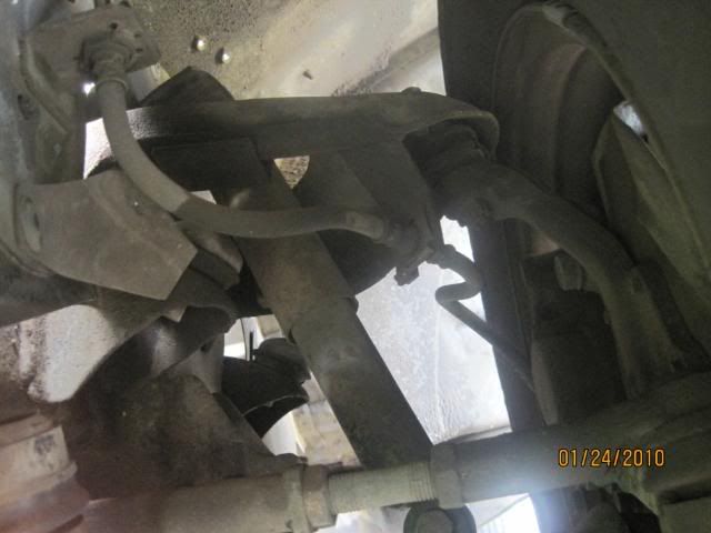

    whats up everyone...new to toyotas, have done as much research as i could trying to find my answers but figured it was time to get the help from an online forum.
    i picked up an old 42 ford with a toyota front and back half...cant find any info on what year frame/suspension he used. the run 6 lug pattern, and yea...
    ill post a couple pics in hopes that someone could really really help me....:confused:

  2. burnzya
    burnzya Grand Toyotaholic
    May 23, 2008
    4,457
    arizona city, arizona
    bodied 73 hilux
    i would call that a 79-83 yota frame... but it should be a 5 lug. only yota 4x4's are 6 lug. maybe somebody swapped in 4x4 spindles.
    can you post some up close pics of the back of the wheel and spindle?

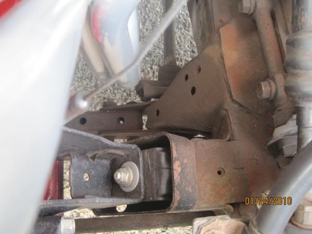

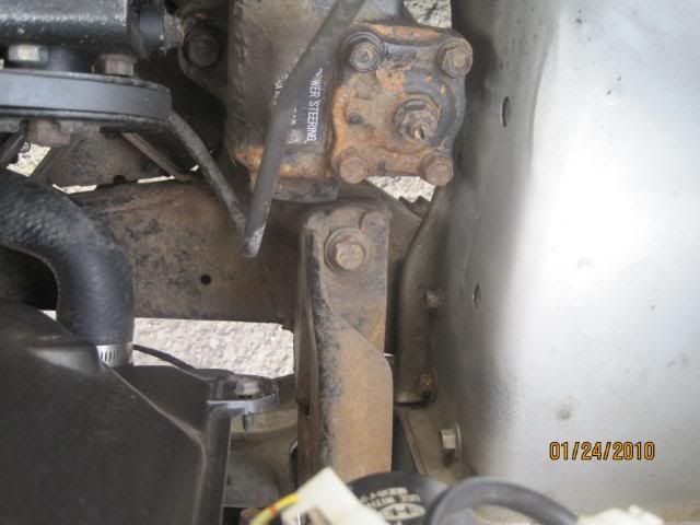

  6. Badlux
    Badlux Enthusiast
    Feb 19, 2008
    274
    Kaneohe, Oahu
    87 xtra cab
    Looks like a mazda frame. As mentioned, B series Mazda would be 6 lug. I just looked at my mazda and the front bumper mounts are the same as yours with one bolt on top and one from the front. My Mazda also has the same cross member with the holes. Im getting ready for work so Ill try taking some pics later so you can try to compare my mazda to your frame. Mazda B2000,B2200 86-93 could be what you have. Nissan D21 hardbody 86-97 also was 6 lug and the front bumper mounted the same way.

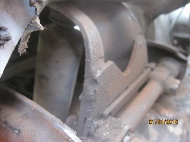

  7. 70_boosted
    70_boosted Newbie
    Jan 24, 2010
    here is a couple more pics, but from what i see, it looks identical to your mazda setup...is that good or bad?

  8. Badlux
    Badlux Enthusiast
    Feb 19, 2008
    274
    Kaneohe, Oahu
    87 xtra cab
    mazda b2200
  9. 70_boosted
    70_boosted Newbie
    Jan 24, 2010
    that looks alot like mine despite where dude hacked and modified the bag mounts with some poor cutting and welding:brickknock: how would i go about converting to a 5 lug? is there spacers out there? kits to do it? etc...im going to be running a z-d rear frame piece gm 10bolt with the 5 lug...only because im running a turbo'd v8, unless i can be pursuaded to run a smaller motor...turbo'd of course
