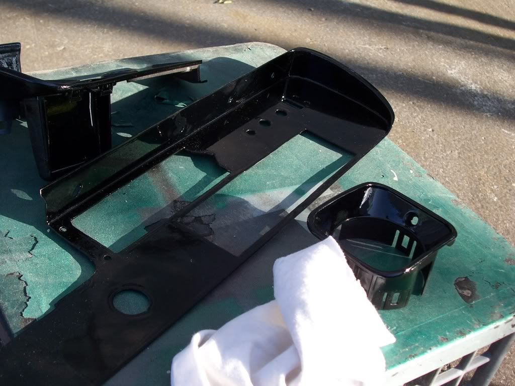

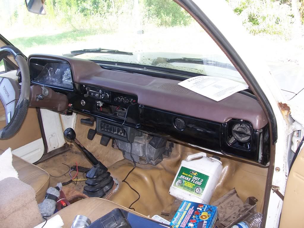

    here is what i did for my 2wd dash.. this one is a replacement one made cutting/welding spare street signs..(don't breath the vapors)
    [​IMG] installed
    but you could also make one that is just the face piece(to fit inside stock plastic piece) by cutting out a template and making a few tabs on the piece of metal and then cut a few slots in the dash to hold one side(passenger side) and then a screw on the side by steering wheel where there is one already.. by cig. lighter. and just cut out square holes around a/c and catch bin.. and if you cut a sideways H as the hold for the radio, when you fold the two halfs back it makes a good mount for radio holder. but you do have to cut a piece of your dash to center the radio.. that's how i did my first truck with diamond plate, and then did the same thing on other side of dash to match.. sorry no pics of it.. it was before the digital revolution.
    don't know if that makes sense, that whole pic is worth a 1000 words and that was like 100.....

    the installed picture is very miniture

    i made the installed one as a clickable one, it should blow up.. didn't wanna jack thread so just made the pic of piece big. cig. lighters are simple and pretty universal in fuse/light bulb section, the contact on one of my dimmers was worn out or coroded or something and i sanded the contacts and helped i would check fuses if none of that stuff works.. unless the shop already did with the not charging thing.. there is a fuse panel under the dash that has interior and crap in it. i would start there.
    oh.. i just clicked on it.. it is miniature.. ha ha
