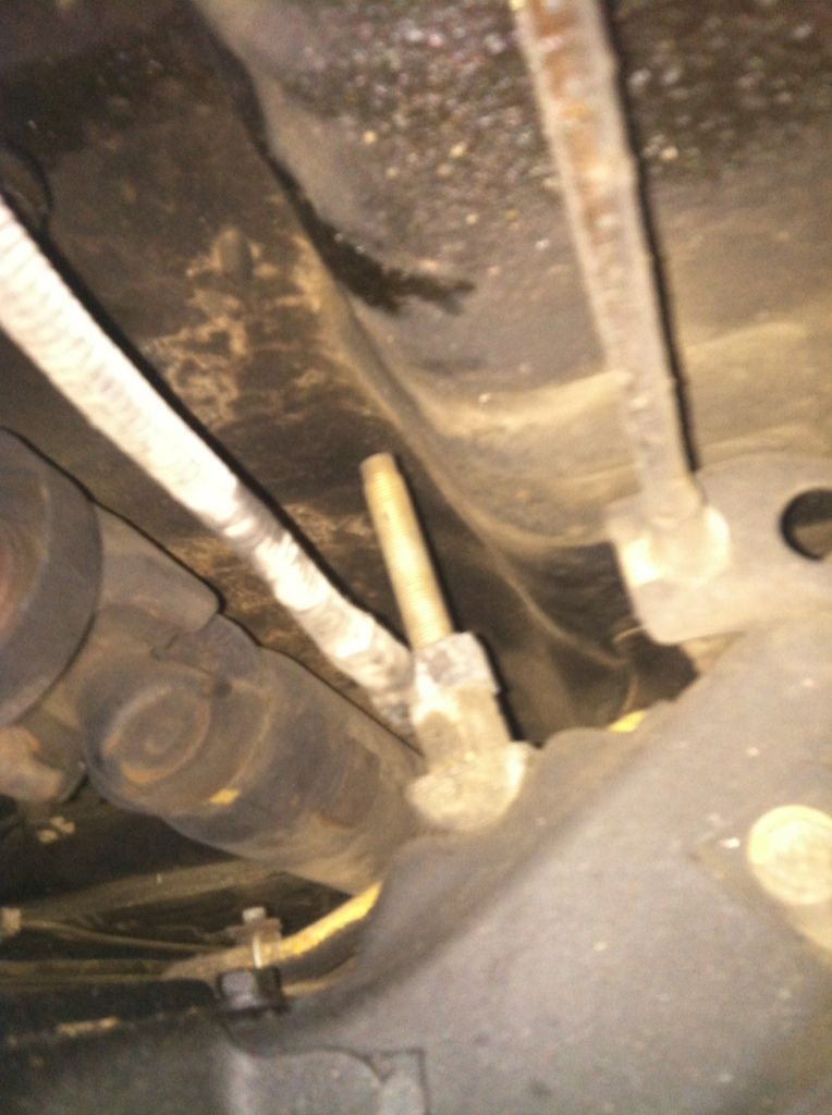

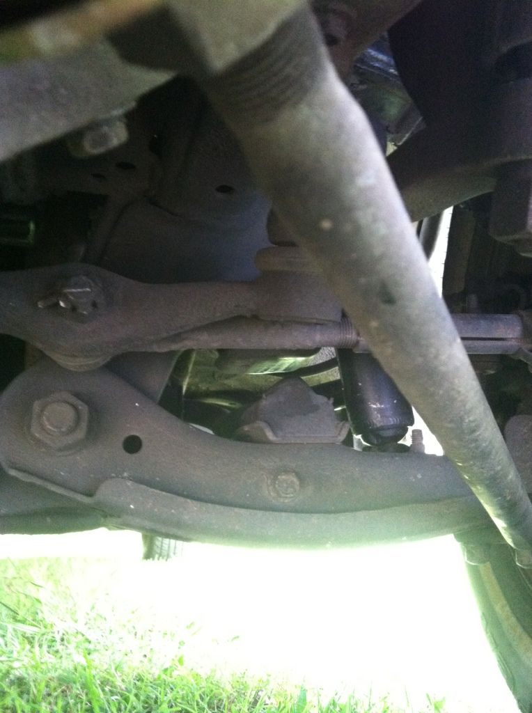

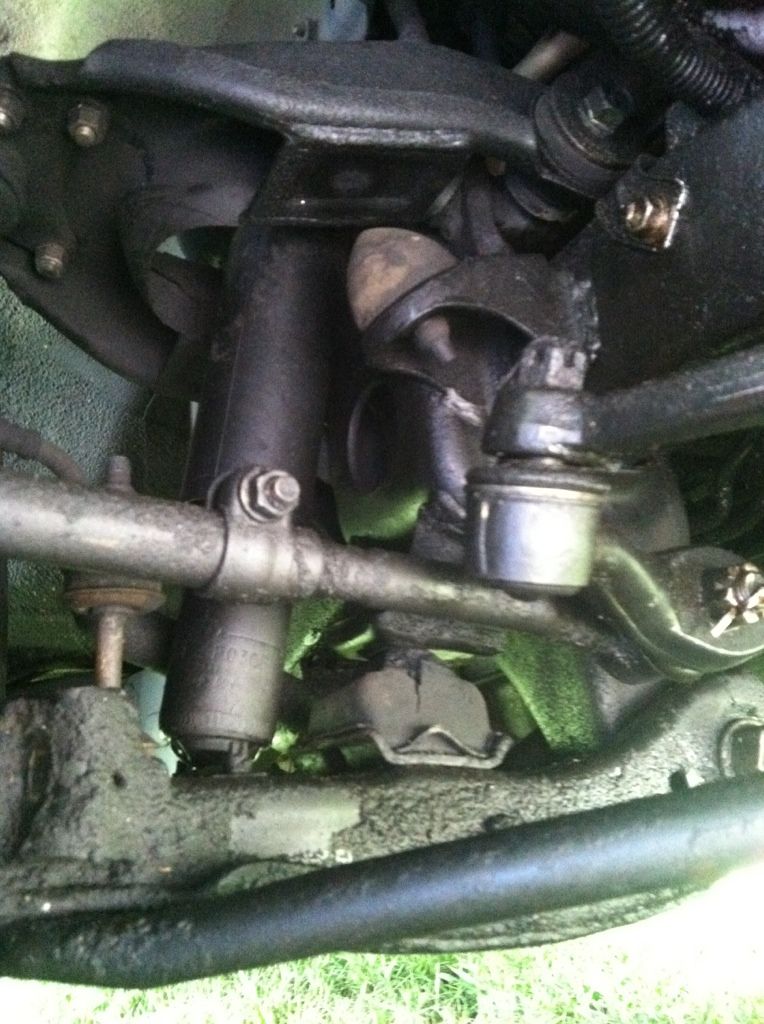

    DRIVER SIDE:
    [​IMG][/IMG]
    PASSENGER SIDE:
    Yah yah yah its dirty, but let's get to brass tacks. :p
    I'm not sure if the persone before my uncle had it lowered and never put it back up but I haven't touched the front suspension other than new front shocks like a month ago..

    Go under and look at your tortion jam nuts and the amount of thread you have on each side.

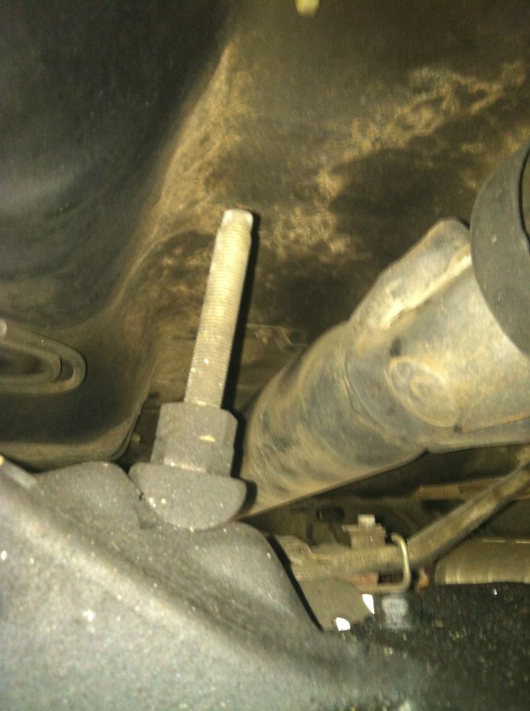

    The threads left are about 3-4 inches I'll snap some pics and post em up...

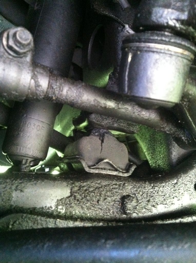

    Passenger side
    Driver side
    I'm assuming that's the correct adjuster bolt, never really delt with torsions other than the race car and we deleted them and went coil overs anyways...

    You look to be even on your thread length from the pictures of the torsion bolts has any body ever taken the bars apart the ends come of the bars and can be reset at a different angle if you don't mark we're lower control arm peace was in the first place it will be outta wack theses bars support the truck up front as I'm sure u no I would loosen the pass side jam nuts and crank it up a bit see if that levels you out I don't see it being anything else doubt a blown shock will do that

    Naa it won't mess anything up if the noise /feeling u were describing doesn't bother ya to much then yea roll with it until u bag it but if u wanna even it out just loosen that top nut hold the nut under it with a wrench throw a ratchet on the bolt that the long threaded one < and tighten it up about 10 to 15 turns should get u off the bump stop maybe tad more cinch down the top nut and done

    Starting to think that feeling of lobing is the bump stop hitting the lower control arm. Might just get some blocks and lower it even more. :p how much can I cut the bump stops down?

    I took my bump stops out but I also have toxic shocks which are sized for the drop. If you take out your bump stops or shave them your shock might just bottom out giving you the same feeling. I would just adjust the tortion till the front end levels out and keeps it of the bump stop.

    I shaved the "mountain" off the bumpstops up front... but yours... you hit something and it's bottomed out on the passenger side, I'd fix that first. have you jacked up the truck on the passenger side yet?
