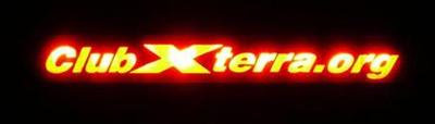

I use a vinyl diffuser inside all the ones I send out for the 3rd brake lights. It kills about 85% of the hot spots. (in person it has even less hot spots than in the pic)
are those the dome leds? you should switch to superflux 120 degree viewing angle and there is virtually no hot spots when spaced correctly
I don't actually remember, lol, it's whatever comes factory in the oem 3rd brake lights. (I think they're domes)
