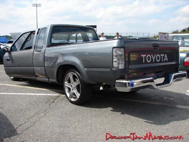

    Yes they will fit, but youll need spacers for the front. A good friend of mine has them on his extra-cab & Im planning to install mine after the first of the year on my truck as well. He & I both are running 1-inch spacers, have plenty of clearance & you can barley notice the spacers. Oh & I bought my spacers off Ebay too & here are some pics of his truck too...

  9. Sound.Vision.Soul

    Wow they look really good!

    I agree with you 100%...thats why I got a chrome set to go on my truck!! :D

    They look great!!!
