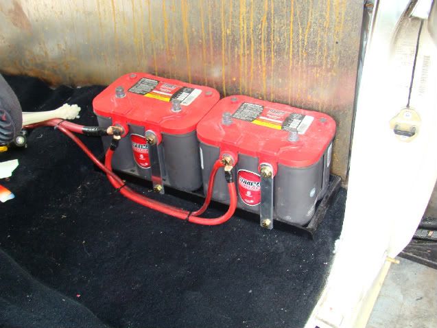

bmjwright has the best solution. I have two of these on my Mercury Custom and one on my 32 Ford Coupe for years. They hold up really well and allow decent access to the battery.
Odyssey Battery switch your battery out to a smaller one. Small enough to put behind your seat or even behind your glovebox Warning, They ARE PRICEY
I have a Odyssey PC1500 in a battery box from Summit,behind the drivers seat .With both positive & ground distribution boxes over it. Changing the hold downs right now so can remove the nuts from the top instead of the bottom. Also run all 00 cables to a main ground @ the frame & to another distribution box in the engine bay.

Here's what I have ,one positive & one negative distribution box above the battery ( the positive one has a voltage read out), the other stuff is the air management ECU, & pump relays.Most of all in the cab is for stereo amps,pumps & air controller! The silver box in front of the battery box & on the side wall is the electric engine fan controller! The distribution box in the engine bay ( circled) gets a feed from to battery, & feeds all there,the main fuse panel @ the engine gets power from it & back into the cab through all the stock wiring! Built by me ,for me & driven hard!!
