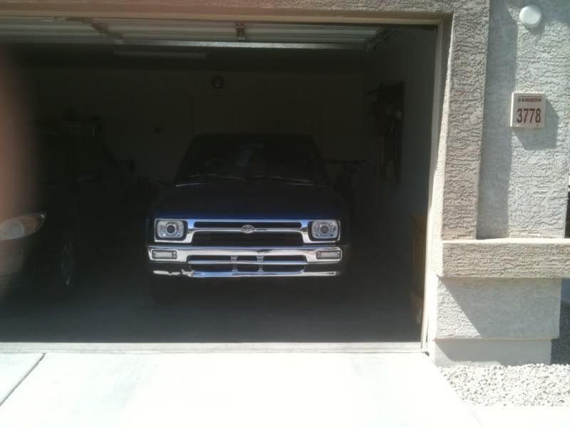

  5. joeynational
    joeynational Toyotaholic
    Feb 16, 2007
    1,378
    9
    PHX,AZ
    91 2WD
    projector retro fit on mine...i've had both..nothing comes close to the projector retro. check my build thread for info

    the projectors don't look too bad. i've had a pair of h4 conversions with the fake projector thing in it. it looked kinda weird but if you retro fit like he did then its worth it.

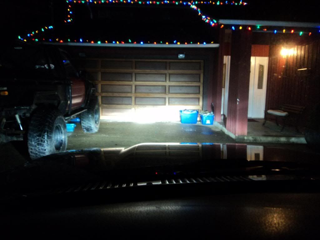

  14. NashMan
    NashMan Toyotaholic
    Nov 11, 2012
    1,209
    16
    Vancouver Island, Canada
    94 2wd
    ya I can get the e code but there 100 buck's before mass discount
    then have t buy the hid kit and the pig tail to convert it over
    but I have yet to see what they look like on a wall

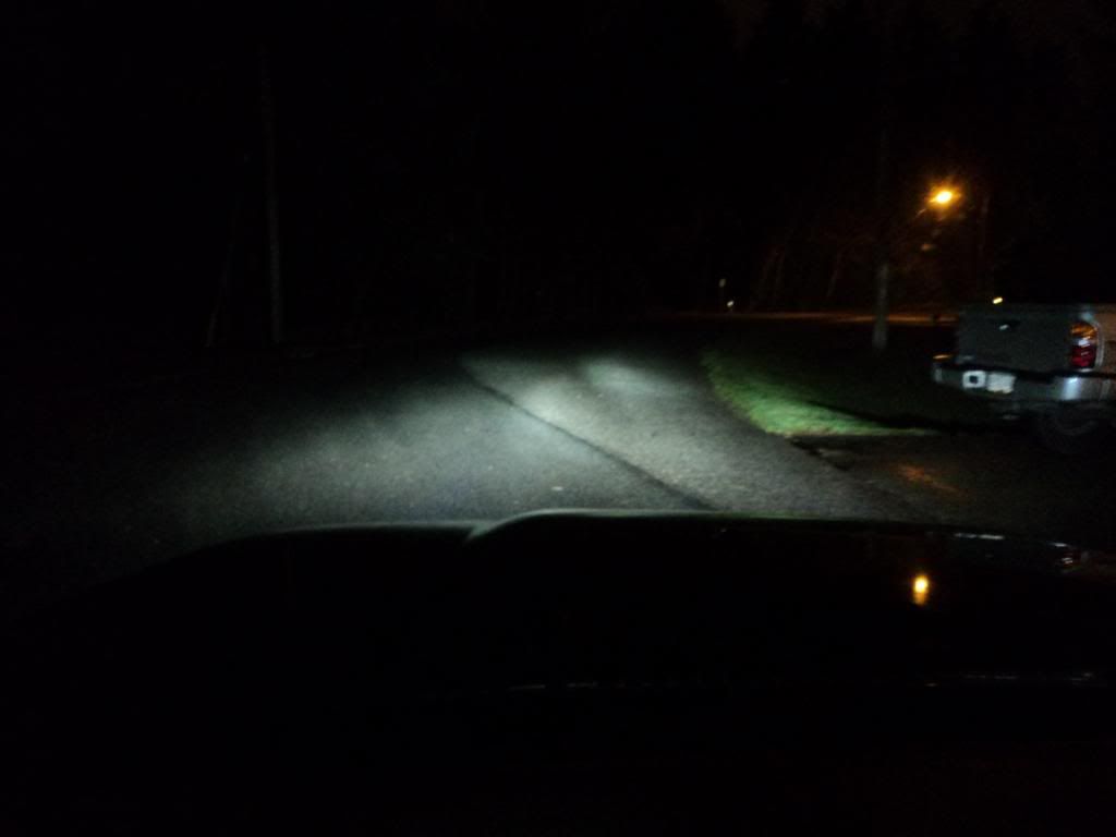

    retro fitting some projectors should help clean the output up. that way, you wont have all that scattered light.

    That's about the norm ya gotta rember this bulb technology was designed for a projector lens so like byronics said a retro will get you there for the time being try adjusting your light that last pic looks like you could raise it a few

    funny par is I adjust them and well not so great resalts
    these's are the high/low kit, so the bulb moves.
    Far as I know they can not be used in a projector with a cut off lens. that function that control the bulb pop in and out can not control the shutter far as I know
