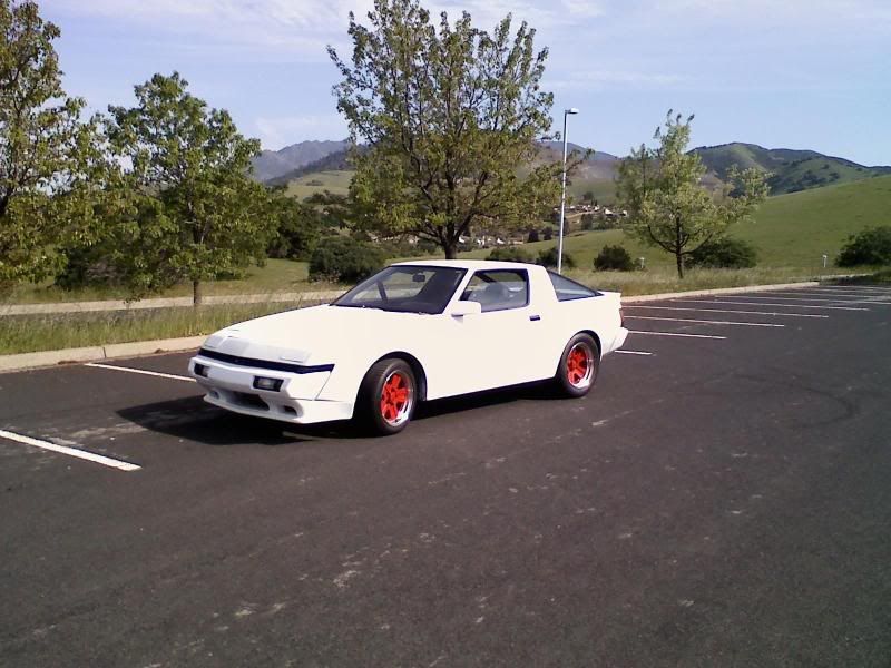

    Hey, new to the site. I am a starion guy, got it fully built 16g turbo mpi running megasquirt.....see pic below! Im here to look for info on my buddies truck (Erik beeman @yotatech.com) he has a 2wd 88 reg cab. The original plan was to fully build the 22re but its looking to be to much trouble with not enough benefits. We purchased a megasquirt and had it running (its now for sale) but we have decided to go with a 1jzgte, 300hp for $3000 is definitely worth it. If someone can point us in the right direction for a rear end that will drop in with ease and hold the power I would appreciate it.

    oh and sorry for the crappy cell phone pic
