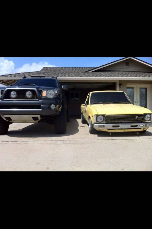

    I hit a rock in my 1980 going to go ride dirt bike and it ripped out the adjuster nut on the torsion and the torsion bar itself came out and said F it and removed both torsion bars by any means this is not the safest thing to do but hell I drive so slow in this small island of mine plus it's stock 20r top speed is like 90mph in this truck highest posted speed limit is 55mph and well it wore through the bump stops and is pretty much metal to metal on the LCA and truck sits about 1" or less above the ground by the front crossmember and have gotten the truck stuck just pulling into the bike lane 4 tires still on the paved road

    Truck next to me is 3" drop and doesn't look that low by the wheel gab but that's cause the camber and they are 14x7 welds

    My tacoma has a 3" lift next to my 80
