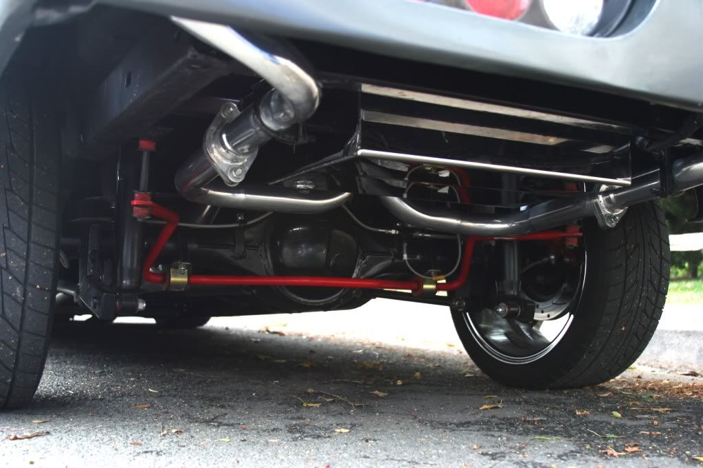

    94 regular cab hilux with a 22re
    does anyone on here have a sway bar on the rear, or know what vehicle i can steel one from, that will not require too much butchering to make it work?
  17. TRUCK ACTION
    Jan 5, 2008
    4,188
    600
    Vallejo,Ca.
    88 Extracab,2wd
    My rear Quickor Performance bar, 4140 chrome-molly spring steel, part number was#22582
    Glen Rissberger may still be making bars out of his garage. He was the owner of the company,& was last talk with him
    503-819-7847, Portland OR.

  20. TRUCK ACTION
    Jan 5, 2008
    4,188
    600
    Vallejo,Ca.
    88 Extracab,2wd
    Factory bars will work if you get them to fit!
    But handing is better with a larger dia. bar of any type. The Quickor bars are the best I found. I first ran them on a very heavy E-250 Ford van with a modified 460 cu.in. engine /close to 600 hp, & it sat high with 16.5'' rims/handle like on rails!
