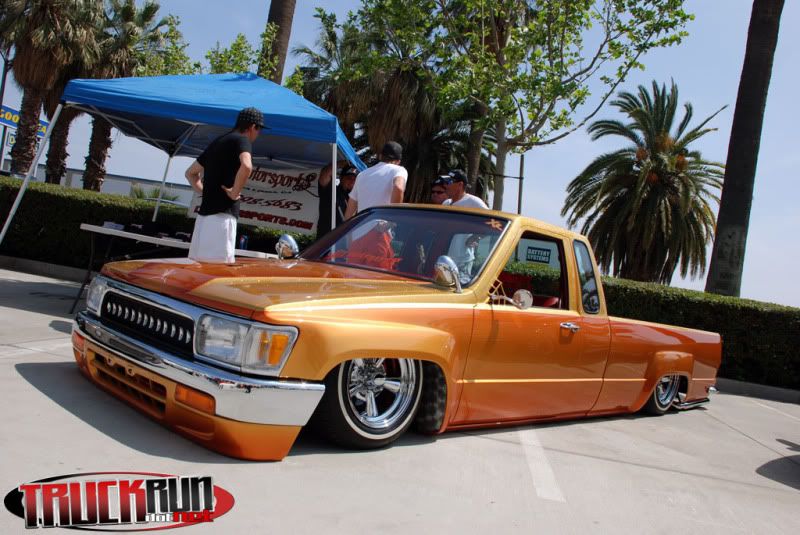

    2000 Toyota Tacoma 2wd
    the initial bumper will bolt up but the outter brackets for the end caps and outter valance bolts will not. you will need the outter brackets from a 4wd. the brackets will bolt up and will line up correctly after.
    this is my 86 with the 4wd bumper, 4Runner grill, and 4wd valance.
