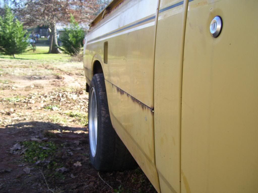

    Not much to report. I've been down with the flu the past few days. I did get a moment today where I felt good, so I did a little work. I got the fender, better bumper, new valence, and a grill put back on. Didn't have 2 pieces the same color, but no biggie. It'll all be satin black eventually. I also swapped tailgate latches from the red truck, and a few interior pieces.
    I haven't bothered putting wheels back on yet, as I have a set of Starion rims coming Saturday. After that I'll roll it next door to my dads shop, and the 7m swap fun will begin.

    Love the farm drop on the back. Flat tires FTW :lol:
    Looks alot better now. Starions should fit well. What combo of 7s/8s/9s you gonna run? I have some pics of starions on 2nd gen hiluxs. Ill post a couple.
