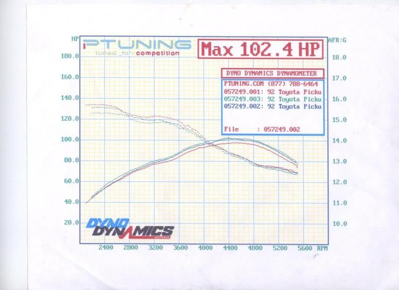

    So I finally had time to myself this morning and put the roach on a dyno @ p-tunning in manassas,va. They did 3 pulls and afr for $75.Motor is a 22re for reference My engine mods are .40 over,intake,header w/ full exhuast. So got a baseline b/c I have a lot of parts that I have been sitting on for over a year. Got a whole top end setup. I will be slowly working on this but with work and life could take longer. But onto the results. Will post photos later.
    Hp: 102.4
    Ft lbs: 124en
    Not to bad I think. This is to the wheels numbers. I would like to see 125ish when done. The point of this build is power,durable, fuel eco. Right not I get about 28-30 so I'm trying to have my cake and eat it too. More later.

    Ok so took me longer then I said but here are the graphs
    HP/TRQ
    HP w/AFR
    So I have some tuning to do. Im getting a wideband and once I get my top end built I will tune and re dyno. I hope to have this done by March(ish).

    Good numbers for your mods

    THANK GOD YOU HAVE A DYNO OF A NATURALLY ASPIRATED 22RE that's not too modified. I just wish someone had a dyno chart of a healthy stock 22RE.
    If I'm going WOT, I'll shift at 4800RPM, seems to be the right point.
    gives me a good idea what the trucks can do.
    AFR's seem to be quite lean down low, i think it's normal though?

    When I rebuilt the motor 20xxxx miles ago I never tuned it and it has been good to me. After this run I run lean to start then is starts to get rich so I'm hoping the new ported head with cam and cam gear and a few other tricks I have planed with make more power and fix my afr numbers. If I had been on a dyno jet my numbers would be 12% higher. I'm happy though that I had this done to serve as a reference.
    Btw I'm in northern va so do think I'm to high above sea level.

    Very nice numbers.
    Cant tell you how many cold air, and exhaust civics ive seen on the dyno not even do 75. The people are always let down. :evil:

    Are you using stock AFM??
    I'm not sure how NA motors are supposed to be, but with the AFR's i'm so confused whether it's normal or just because it's OBD1 Toyota 22RE EFI lol

    Those numbers actually look very good to me, about as good as we ever hit with any of our testing. Of course, now it's been well over 15 years since we did any dyno runs and the equipment we had can best be described as....well...old like me...*LOL**.
    I am interested in this one, you are doing very well with your project so far....*EB
