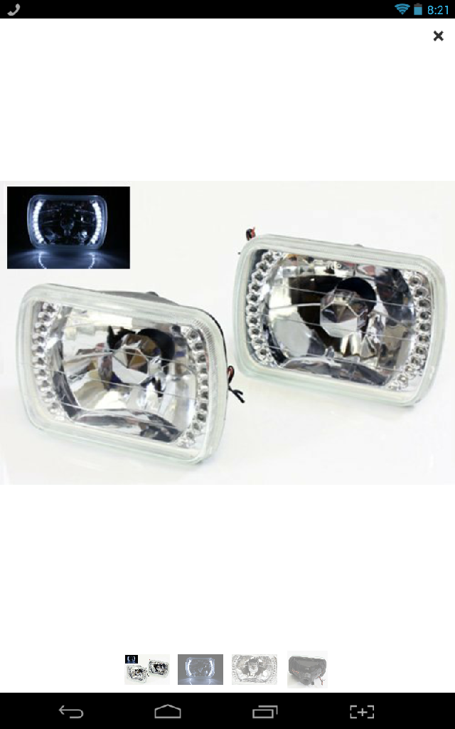

    Can't figure out how to post pics. But they are real close to the ones Jewish guy posted. But instead of the lil blue light, mine has white LEDs on the sides like the new camaros. and there wasn't an issue with them after all. it was still a lil daylight when I first checked them, but after driving home from work tonight, they are fine. the high beam just isn't focused on a spot in the distance like my wife's car. it's more spread out, if that makes sense. I can see further in the distance than the old ones, and they light up the ditches on both sides way better. and thats a big plus for me since I live in the country and see deer just about every night. I am very happy with this upgrade. Now I have way more options of bulbs. Should have done this years ago.

    Finally figured out how to post photos. These are the headlights I went with. The LED's are brighter than I thought they would be. hooked those up today.
