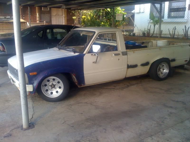

    Pictures from when I first got her (after I cleaned her up a bit):

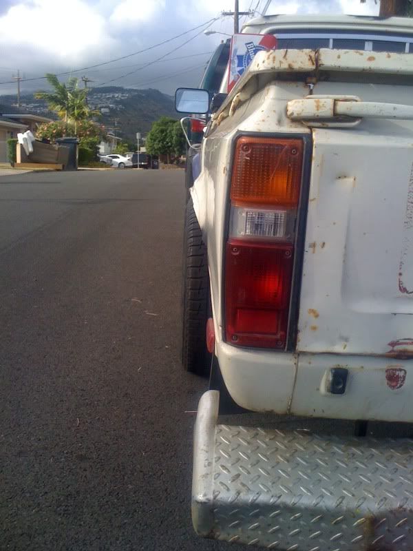

    Bed Rust:

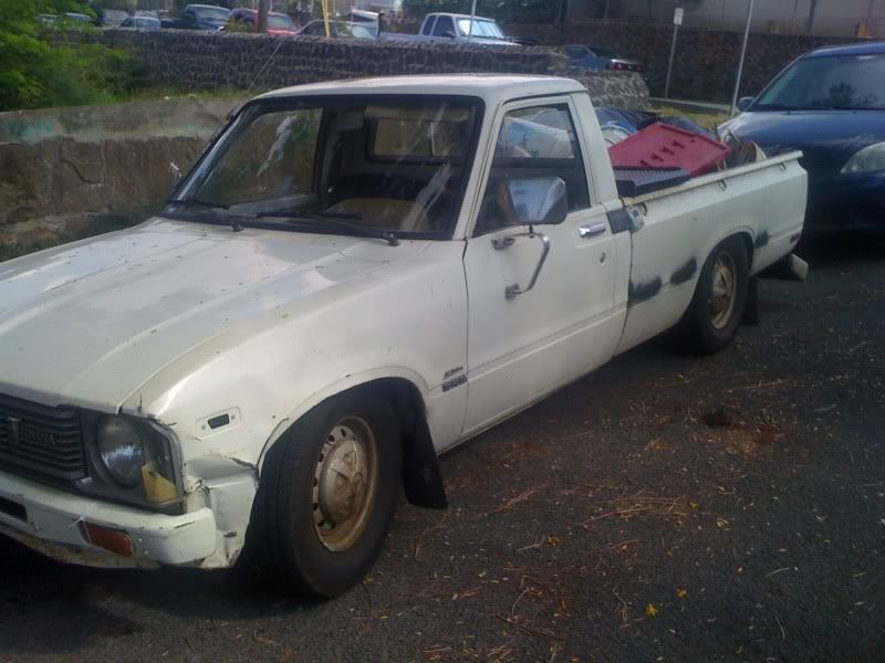

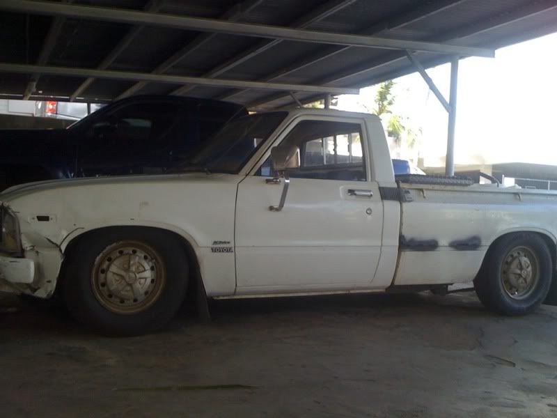

    BEFORE:
    AFTER:[​IMG]

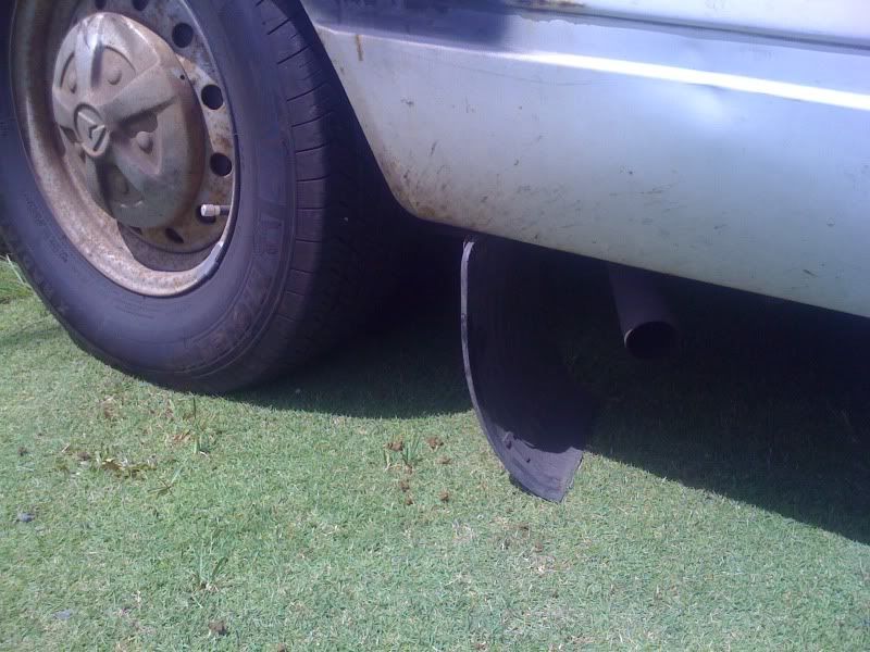

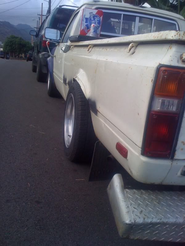

    Dragging Mud Flaps!

    To drop her I rekeyed the torsions giving me a ~3.5 inch drop in the front. I removed two of the four leaf springs on each side and put in three inch blocks from O'reilly Auto Parts. They were $30. That gave me a ~5.5 inch drop in the back.

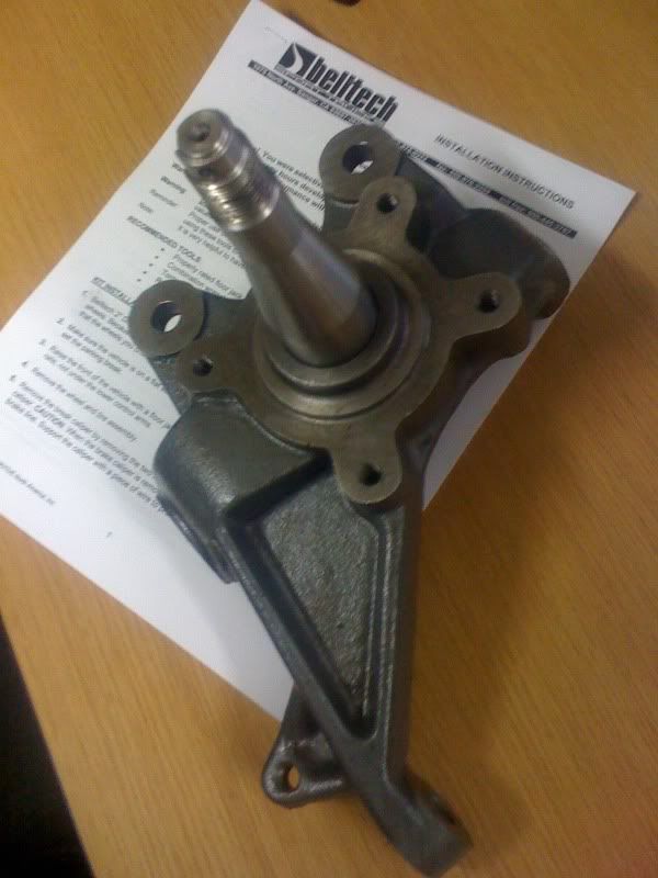

    Yesterday I pulled the front suspension off of a '87. The guy also sold me a set of 2" Belltech drop spindles. When I do the suspension swap/drop spindle install I will document it and write a How-To and post it up. That will probably happen in the next few weeks.
