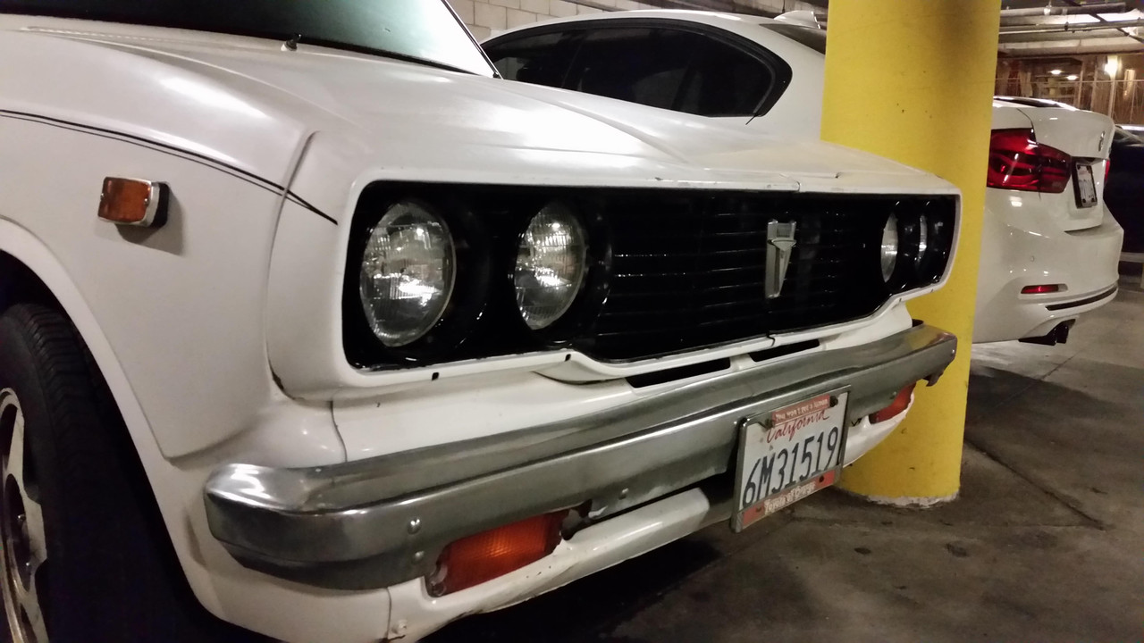

    POST EDIT
    All the early picture links are broken. I have changed the hosting website in the later posts. Here is a picture of what I started with and where im now. This is still and on going project.

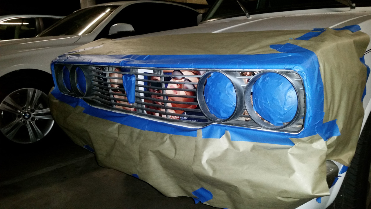

    A little bit of an update, I did the window tint and painted the front grill this weekend.
    Supplies i used and the tint I bought form auto zone for $30. I used a %5 on the rear glass and %25 on the side windows.
    Masked on and ready to paint.
    Now your probably asking, to why did he not remove the grill its only a couple of screws. Well that is a very good question and I would ask some one else the same question. Until I unscrewed all of the screws from the clips that hold the grill in place and find out that the corners of the grill are screwed in bondoed and painted on top by the previous owner. He was a body shop guy so he screwed and patched the grill to stay on.
    Its kind of difficult to see here. I cracked the paint and bondo to see for my self and this is in all 4 corners. So I would of had to break the bondo, drill the screw out ,remove the bumper and paint and then reapply all of the bond and paint in white. Waaaayyyy to much work, just to paint the front black. So I masked it and painted.

    Looks alot better blacked out
