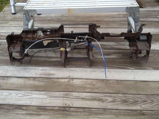

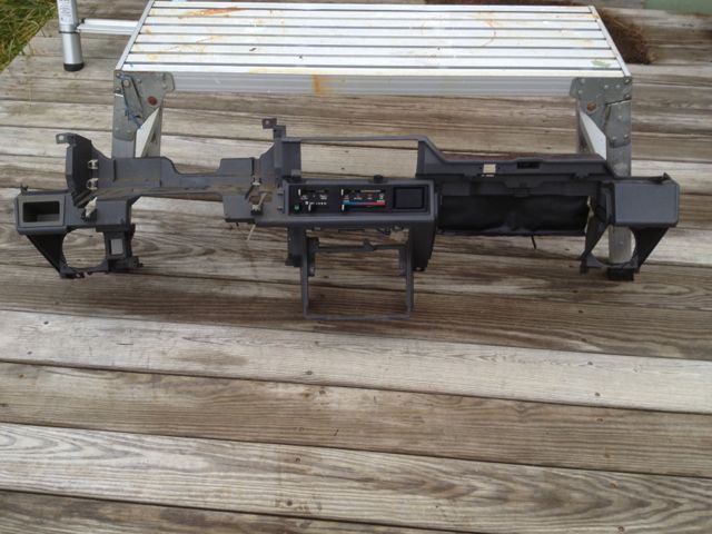

    I've got this in my garage, along with a bunch of other parts I can't think I'll need. I'd like to turn it into money. I haven't pulled the compressor or core yet, but I have them too. (The plumbing was damaged and it's not a known working compressor.) But will this fix any of the problems listed in this thread?

    '82 p/u A/C controls
    Well, I've been absent for a while and I missed this post. The parts shown are different from my old '82, but similar. I'll try to post pics to clarify what I need. And Thanks to all for the help. Toyota dealers are reluctant to help as they know the parts are not available anymore and I get different answers about what is and is not "Boost Ventilator". :confused: Please see page 2.

    82 p/u A/C controls
    Pics of the A/C controls. This is with factory air. The cab chassis is from Japan, the long bed was installed by Toyota in California. Can't find a dealer that knows what the difference is between "With Boost Ventilator" and "Without Boost Ventilator". Please click on the pics to enlarge.

    If you are not speaking with a long time Toyota parts dept veteran, then they are probably avoiding your question. My local dealer has a staff member & a Parts Manager from the 70's that knows all of this stuff about the vintage Toyota's. It's like talking to a person who knows fuel injection only about your carb problems. Non-boost & boost ventilators share the exact same control panel with the exception of the fan switch having an extra speed and control ring to add or subtract cooling & the A/C stamp on the face plate.
    Your original question requested for a source for a new climate control panel. I'm assuming you are in need of a replacement because one of your control links is binded up. If so, then salvage yards are a good source. There is also a Toyota Truck Dismantlers here in San Jose if you want to go that route.
