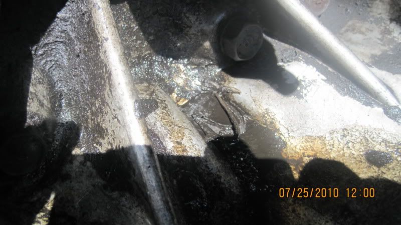

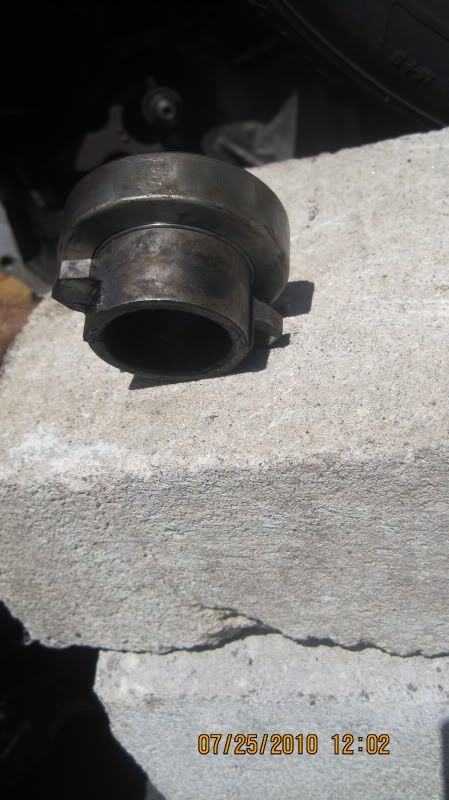

hey. just saw your post. it could possibly be the shifter seat bushing inside your shifter plate. also, these clutch forks are forged steel and this usually happens (happened to my 5spd w series tranny or it coulda been a G57 which had a steel housing) The clips popped off the throwout bearing housing This is what the shifter looked like after it broke off from my tailshaft from a tailshaft seal failure which caused a catastrophic failure spitting my driveshaft out
